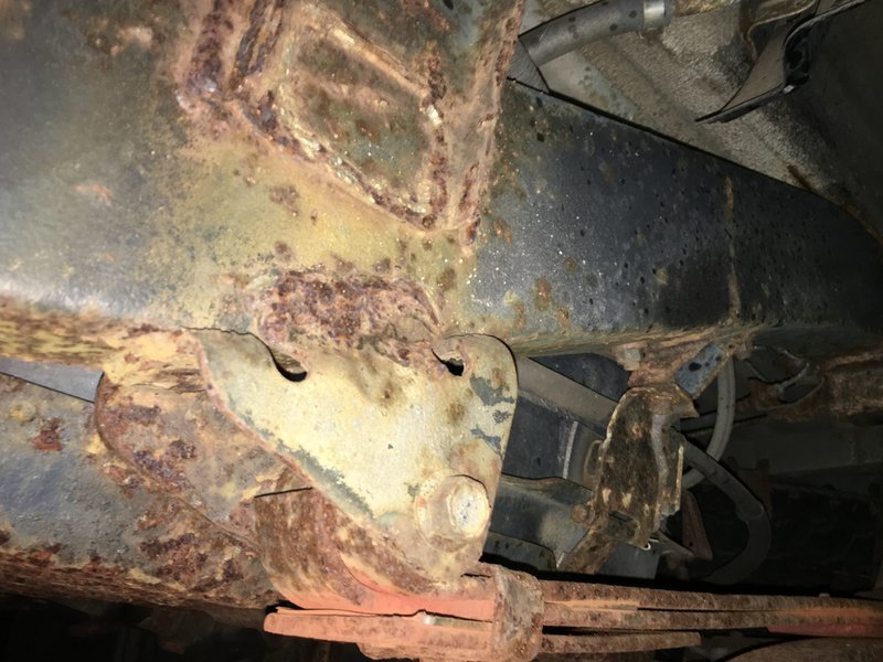

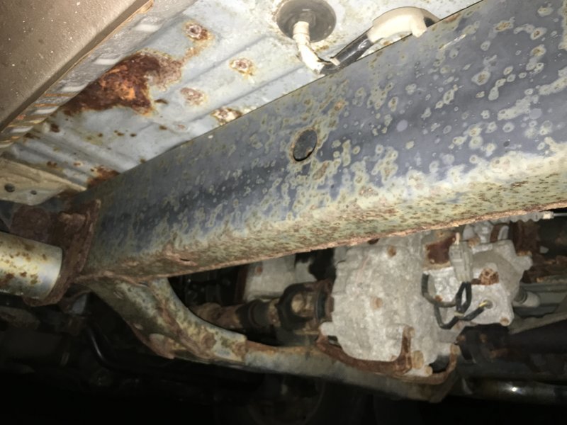

    finally got around to getting some pics of the frame for you guys I think it looks worse than it is:

    These frames can be deceiving cause they rot from inside out. Do the hammer test. If it feels solid. Wire wheel and scrape the all the shit off that frame and paint it.
    Looks like alot of crusty components including that snapped off leaf.

    yea I went around banging on the frame a bit and felt the inside where I could, it seemed real solid. Im gonna go through it tomorrow and check everything and clean some stuff up too (not that its my truck :p)
