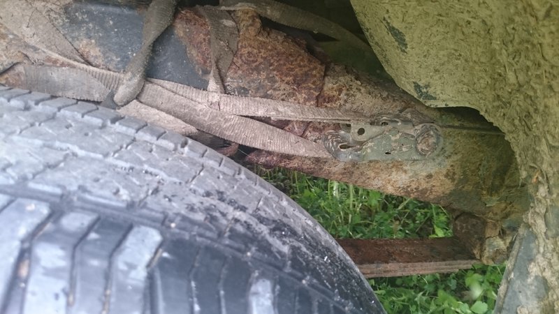

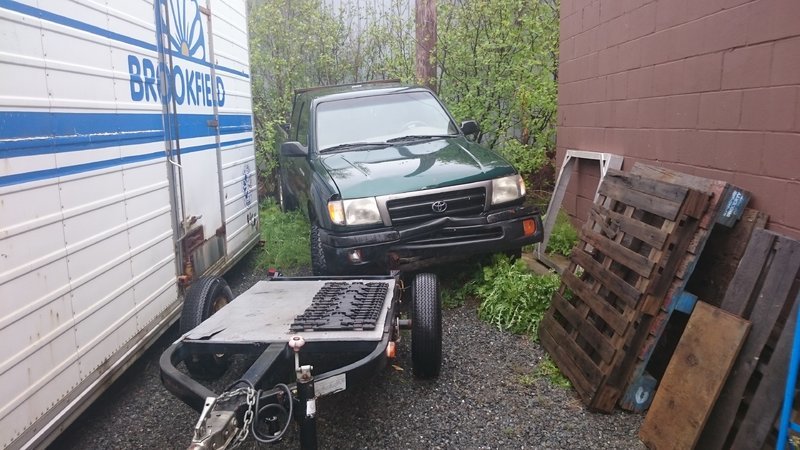

    Found this. Door sticker says its a 96. The entire frame has been plated over but it wasn't enough... This is why 1st gens are so rare here

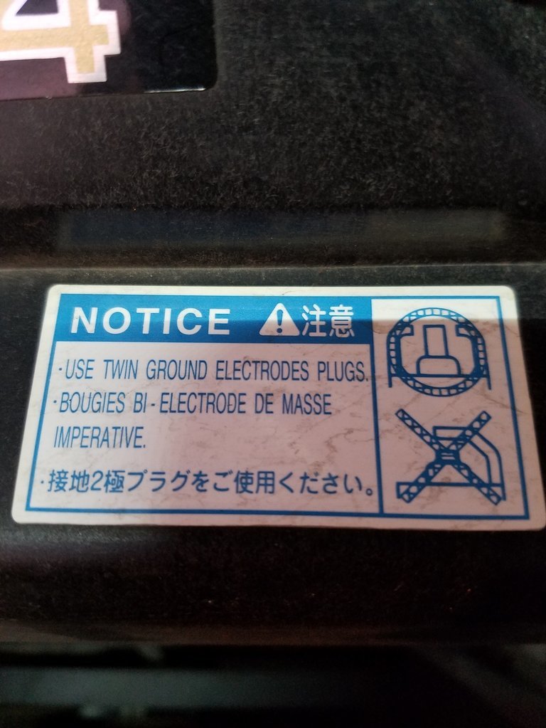

    Small update for the sake of documentation. The misfire came back this morning, not as bad as before, but back none the less. A little research revealed that I used the wrong plugs last time. Apparently this motor MUST have dual electrode plugs. I should have known since it's what I pulled out of it and there's even a sticker on the motor with the same info...I'm sure it's old news for a lot of you guys but I'm still learning about these motors.20160609_210158_5d30ef7942d19da19639a4a77c884352403e8026.jpg
    Today I swapped in the exact part# plugs that the owners manual mentions, kind of annoyed but hopefully that's a wrap on this issue

    That's a 98-00 front end though

    Some 97s got that front end. The 96 on the door sticker will be the date of manufacture. My 99 says 08/98 on the door sticker. I think it is a 97. The op can post the vin and we can run it to be sure. 10th digit indicates model year.

    I kinda agree. If the date of manufacturer is in 96' it would still possibly be a 97. And would have a 95.5- 97 front end. Interesting though. That early of manufacturer I don't see how it would be a 98?

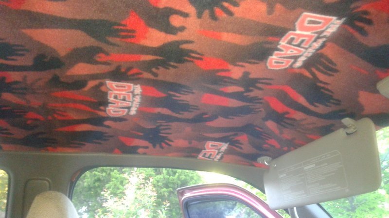

    Headliner - glued over stock vinyl material.

    Front clip swap?

    Figured it out. It is a 2wd. In 97 the 2wd got the 98-00 headlights.

    It has the 98-00 bumber valence, grill, and lights. Hmmmm.

    Sorry, by headlight i meant front end. I just found that rockauto lists the 98-00 style headlight for the 97 2wd and the sealed beam for the 4x4. I also just google imaged 97 tacoma and found the same story.

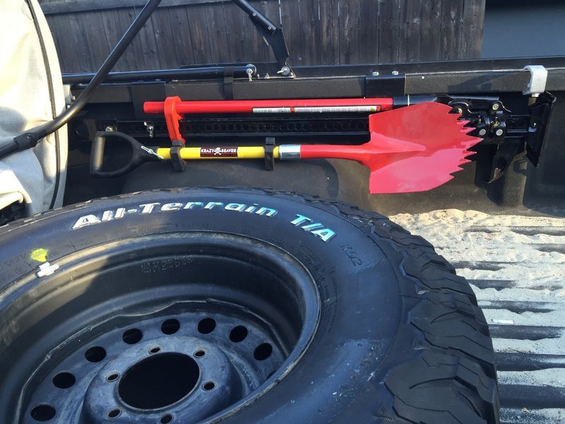

    Hi lift mounted and quick fisted new shovel
    Thanks for custom mounts @Shmellmopwho !

    Heck yeah bro!! They work good for you?

    Yup!! welded bolt coulda been a tad longer but its all good :) and looks good

    Any other pics and details about the hi lift mount?

    Okay cool, I'll note that for any other ones that I make for a 1st gen.
    @SlipperyTaco coukd probably provide you with more pics but I made him mounts that were bent to 90 degree and he vertically bolted them to the top of his bedrails.
