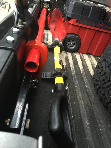

    1.25 x 6" through bolted into softopper and bed rail with a welded bolt at 6"

    Yea...im getting a set of those

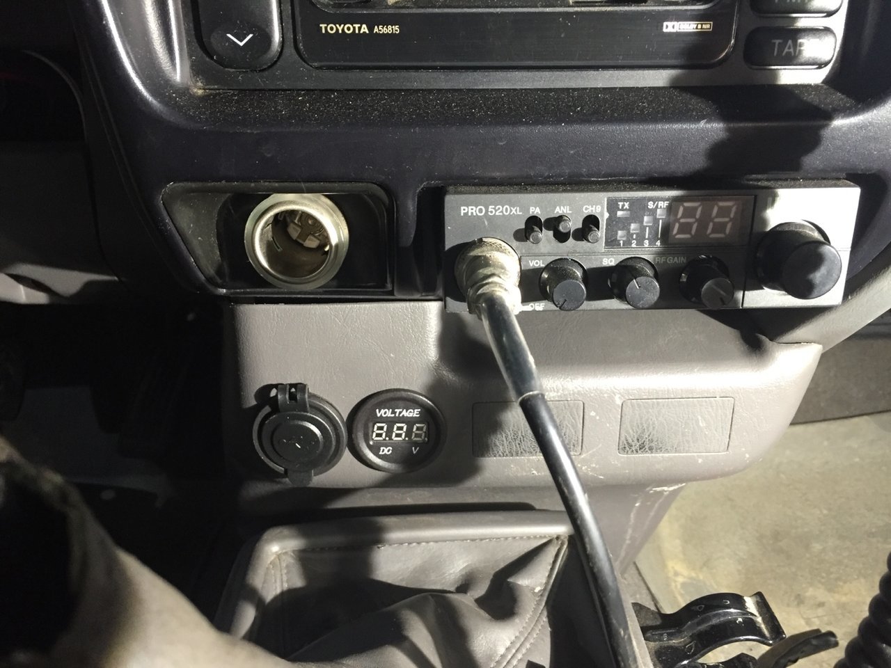

    How did you mount your CB after you removed your ash tray?
    Did you have to remove your ash tray brackets that it slides on?

    Yea, but you really don't have to mount the cb, it's a pretty tight fit.

    What "fitting" did you use at the back of the cb to get it far in like that? I know some have said use a 90* but havent really looked and when I did real quick, I couldnt find them.

    90 degree connector and melting/forming the air duct behind it.

    got a link to the connector? Not sure what to search for

    It's a PL-259 right angle connector. Most CB shops online will have it so whenever you go to buy all your stuff just add it on.

    I actually already have the cb and it mounted in the ashtray. When I did it, I remembered people using a 90 to make it sit more flush but have been putting off messing with it. Your post and picture reminded me. CB I got is a Cobra 19 DXIV

    Gotcha, thought you were looking to install a CB which is why I didn't link to any site. That's the connector you're looking for. Lots can be found, heck even your local radioshack (if you still have one) should have a pl259 right angle.
