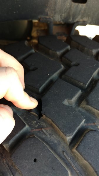

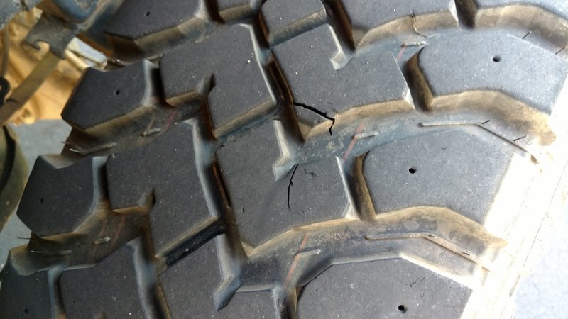

    Mine Hankooks have a bunch of cuts like that where they hit the front corner of the front fender. Are you confident they're not rubbing? Just extra siping anyways.
    How many miles do you have on those? Surprised to see that much wear, seems like you just put those on fairly recently.

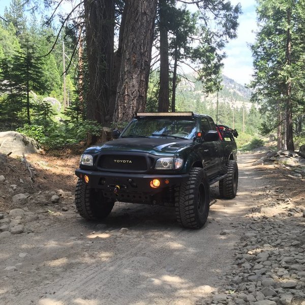

    What are you running now I've looked at your truck before when I was picking out bumpers lol
  13. Jun 14, 2016 at 9:04 PM
    bayareataco
    bayareataco Well-Known Member
    Aug 15, 2012
    #84860
    3,503
    Jimmy
    Petaluma
    2021 Tacoma TRD OR
    in that picture I was on Icon coilovers with 1" preload, camburg uca's, and all pro expo rear. tires were 315/75/17
    now I have a solid front axle with slightly more lift and 37" tires.

    It's not from rubbing, it's the center of the rear tire.
    I'm not sure of the mileage, I had it written somewhere but lost it on the move. I've only had them about a year but put a lot of miles on them in that time.

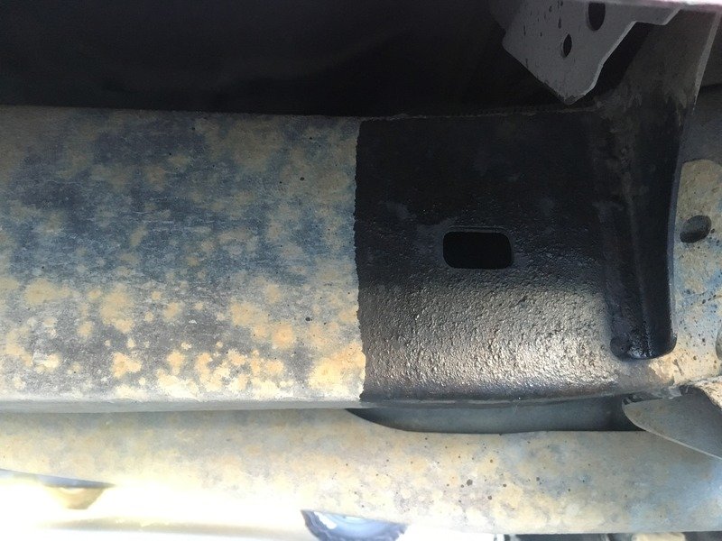

    So I'm in the process of treating my steel boat trailer with Ospho to stop the rust. After I finished with the trailer I decided to do a test spot on my trucks frame. This stuff is pretty darn incredible.
    Obviously the black section is what I treated with ospho. All I did was lightly scraped the frame with a wire brush and then painted it on. I'll have to paint on top of it but this stuff is pretty good so far!
