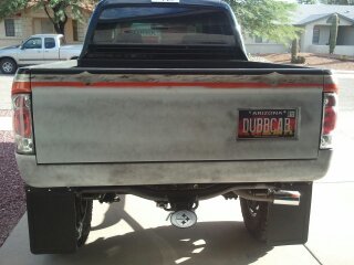

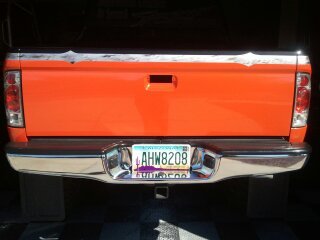

    Shaved tailgate handle, frenched in license plate box and welded in roll pan. Just hoping now that I can match the Orange:confused:

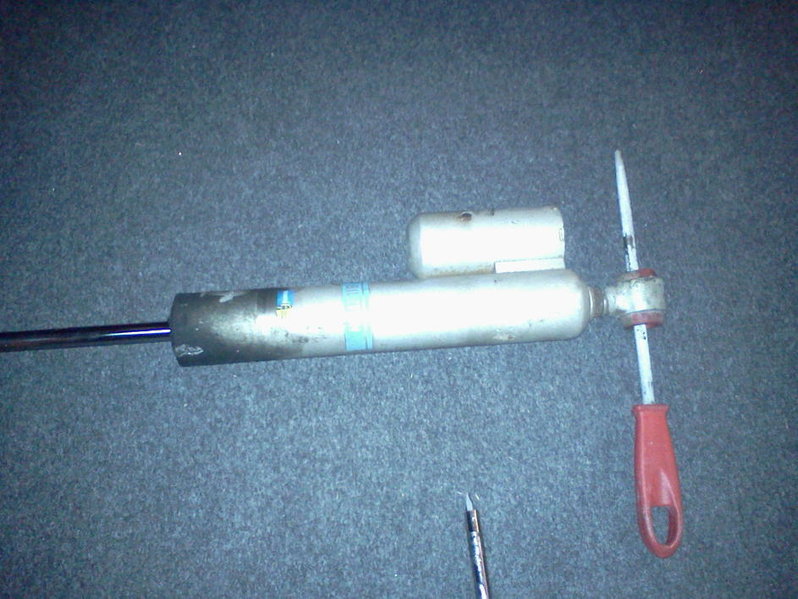

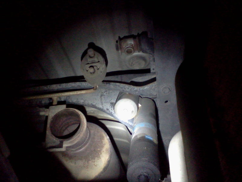

    Coming home from work I noticed an exaggerated amount of clunking coming from the bed. I take a peak and I noticed that my passenger shock is unusually clocked. I snapped this picture (below) once I got home.
    As it turned out the connection from the shock to the mount just "popped" out. Whoever installed the shocks (shop years ago) didn't torque the adjustment nut. And I was curious to why my shock was able to pivot this whole time... pivoted soo much it came off.
    Wrestled it off, put it back together, wrestled it back on, at night, without lifting the truck. :p And the shock doesn't pivot like it's not suppose to. I love it when I make things better than they were before. :)

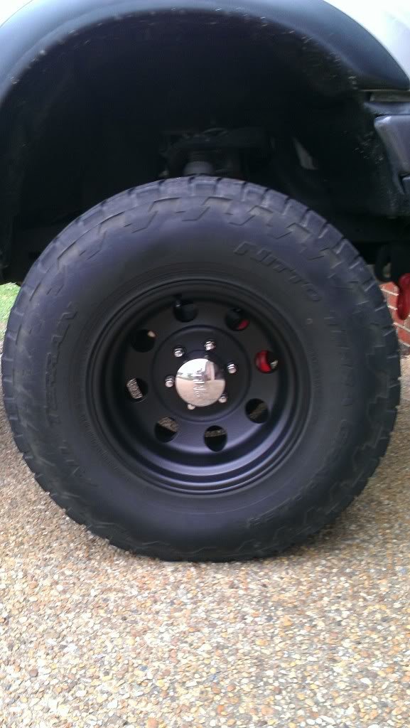

    sold....
    derped my rims

    will be interested to see how plastiderp holds up on rims
