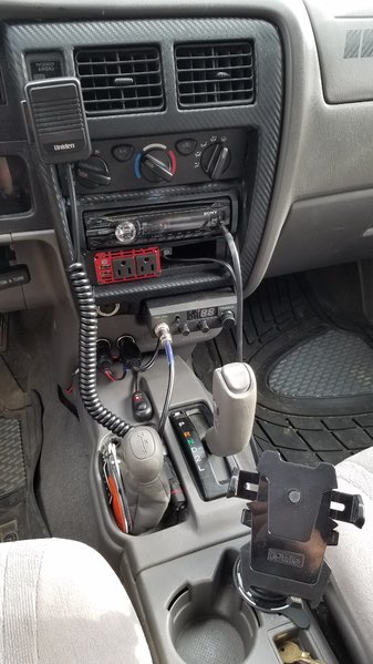

    Hey man, I just installed the Pro 510 XL last week. I'm not sure what the difference is between the 510 and 520, but the install was super easy. I just took out the main dash cover and ash tray. There's kind of a plastic cage around where the ash tray mounts, so all you need to do is cut out the back of the cage to make room for the coax and power cables. As far as mounting the radio, I didn't need to use any hardware because it's a snug fit. This is how mine turned out, if you want a more flush fit, you can get an elbow adapter that will reduce the coax plug's space necessities.
