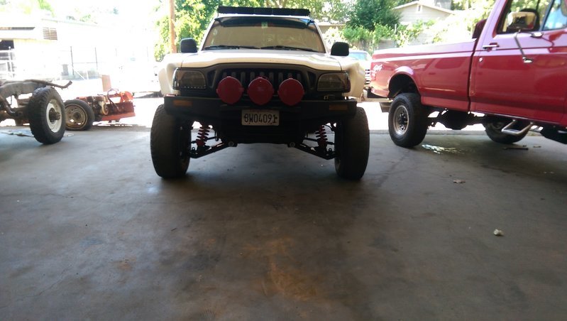

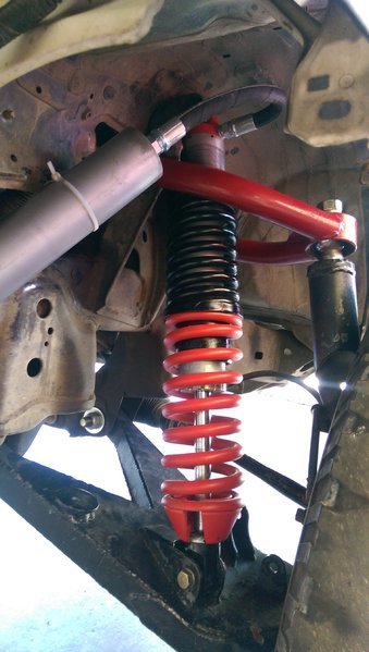

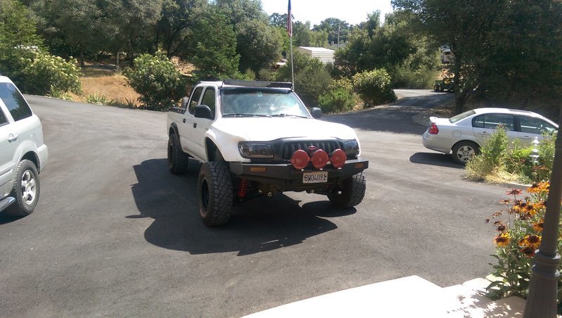

    RedManRocket
    RedManRocket Well-Known Member
    Mar 18, 2015
    #151238
    2,297
    Red
    Sonora, Central Cali
    2002 Double Cab LT
    Esb 5.5 with Kings Mcneil 6.5 fenders Other stuffs
    Well here some material for the day :jerkoff:
    because_wumbo-truck likes this.
