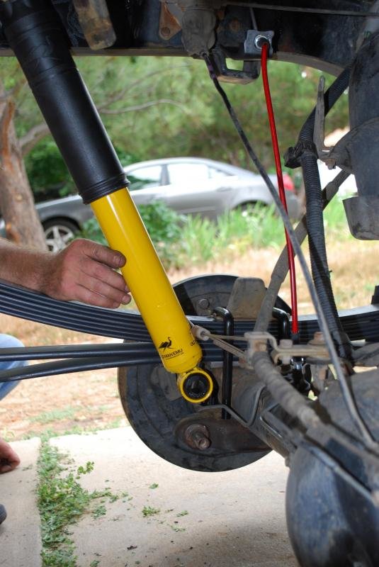

    And here is the pic. Stolen from @Madjik_Man build thread.

    You're right about the shocks topping out, but you're missing out on a a major point in relation to overall travel of the leafs.
    There's really not a good shock length that matches the extended and compressed lengths of the stock locations. This is especially true due to the two sides being different. You're only using 8.5" of shock travel, while your leaves are capable of more than that, but if you put longer shocks in the sock mount, you'll then start risking bottom them out too.
    Why loose travel if you don't have to?
    By the time you get a shock that's long enough extended for the stock mounts, it's too long on the compressed length. Same is true for the opposite. The closest thing to perfect for a lifted application using factory mounts might be 12" Bilstein 7100 short bodies. Whereas you get the extended length, whith a much shorter compressed length.
    A proper relocation can alleviate much of these issues.
    TLDR: hardly anyone that reads this thread would benefit from a shock relocation.

    I didn't miss any point you whippersnapper.:D
    I mentioned the different amounts of leftover travel on driver vs passenger.
    If it helps, it's because the driver side is cycled by the shackle and the passenger side is...not.
    He was asking about mounting in stock location, I gave him the lengths to use and what to expect. I think he has the longer leaves anyway, so those measurements are going to be a bit off in all aspects. My shorter leaves not only droop less, they also compress less. Not ideal from a wheeling performance standpoint, but works pretty well for the shocks. :p

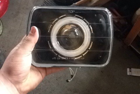

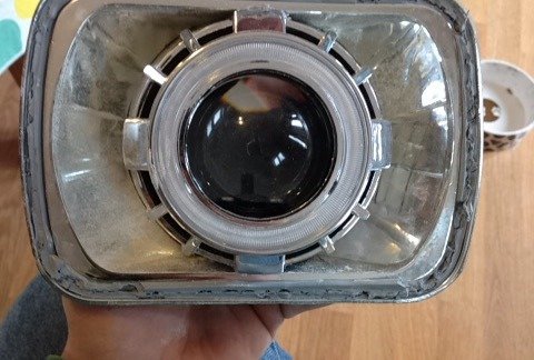

    Then youd need and h1 hid kit? Youl also need aftermarket "h4 conversion" headlight housings. And some kind of dremel. Ive built me second set now and its really just a matter of trimming little by little until the projector lens clears the headlight lens.
  16. Jun 27, 2016 at 7:51 PM
    GreenMachine8
    GreenMachine8 Well-Known Member
    Jan 21, 2016
    #175618
    142
    Elko, NV
    1996 Olive Drab Tacoma DLX 2.7L 4X4
    Off road fiber glass, rhino lined olive drab, retrofit headlights, kings/total chaos mid travel suspension.
    Where would I get the H4 housing?
  17. Jun 27, 2016 at 7:59 PM
    devinzz1
    devinzz1 Well-Known Member
    Jun 28, 2014
    #132892
    7,117
    devin
    lewisporte Newfoundland
    2023 aclb trd or mt
    icon stage 10 kit, toytec 1" bl, 35" general x3s, 17x9.5 procomp wheels, locker anytime mod, s&b intake, blackhawk 2.1 tune,
    Just search for 7x6 headlights and youl see some. Hella and pilot make some. I used ones like these http://www.ebay.com/itm/400694176779
    63307251-522A-4011-AC5F-511FAC59FBD4_zps_82b106d8d2cd202b3a765e6751f896cdf53f607c.jpg
    Heres my first set i tried using mini h1s and ebay shroud.
    DD140CA2-8569-4BDD-BFF0-CD7461C5C34F_zps_1777b7f83495890c6e2d50ff439ec2b816a0b5fc.jpg
    492CB912-5F38-477E-BA99-01BCD26848E5_zps_7f622047a36812b36c85ab0a1fe04bf85a994d91.jpg
