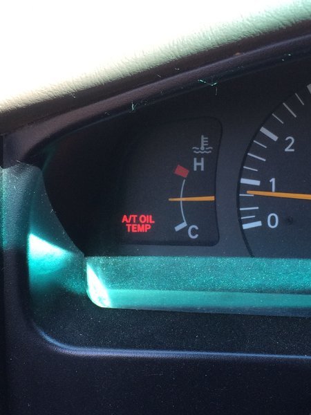

    Were you wheeling?
    I am curious at what temp that light comes on.

    A little

    I believe the temp light comes on at 260+ degrees F, that trans fluid is toast.

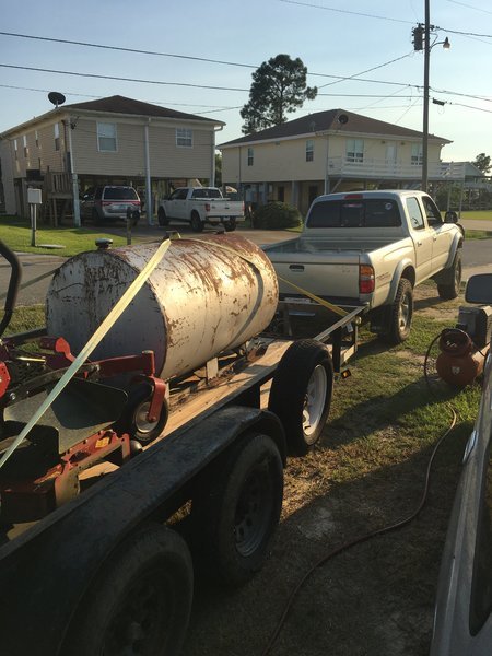

    Getting ready to pull this around, tank is full of diesel and it's all in front of the axle, poor truck has the disease some people call #carolinasquat

    I just stop and waited for It to go off, then went again and didn't come on again.

    I've read that Toyota has set the light to come on at 300*F. :eek:
    I think it might be higher than that. Unfortunately, hydraulic fluid starts to break down at +250*F.
    I agree with you. That fluid is ruined.

    The manual just says to pull over and wait for it to turn off, if it doesn't turn off your in trouble

    Do some research and you will find the manual is wrong, even if it weren't the trans isn't something you really want to take chances with, it's a pain in the ass and expensive to fix once you fuck it up.

    Well shit isn't a tranny flush spendy

    You just need a change not a flush.

    I need to change my oil anyway I guess

    I wasn't even in that bad of stuff, is there anyway to pervent this

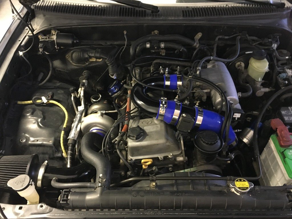

    After about a month of working on this thing, I finally got my turbo set up running tonight:
