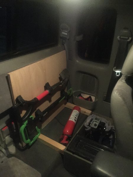

    Pinch weld mod (about time )
    And this !

    Could you put up some more pictures/details of the platform youve built?

    Sure thing
    The back is two shelves (that I found on the street). You could use 1/2 or 3/4" ply
    The base has two 2x2 posts that connect the back board to a wine box that happened to fit behind my seat (I'm 6' 0")
    I may end up building a different box cause I might want to scoot the seat back a notch !
