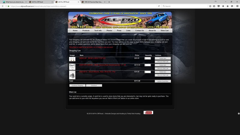

    be ordering these in the morning when paycheck goes through. think thats everything just wish shipping was cheaper lol

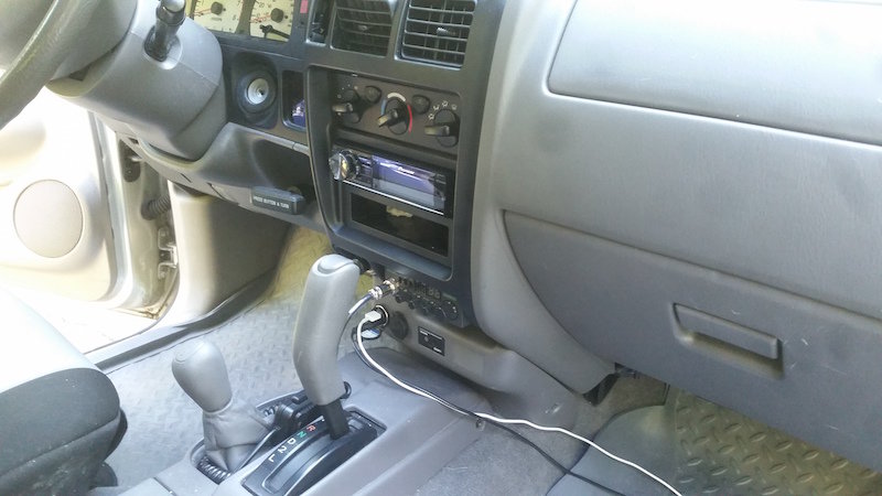

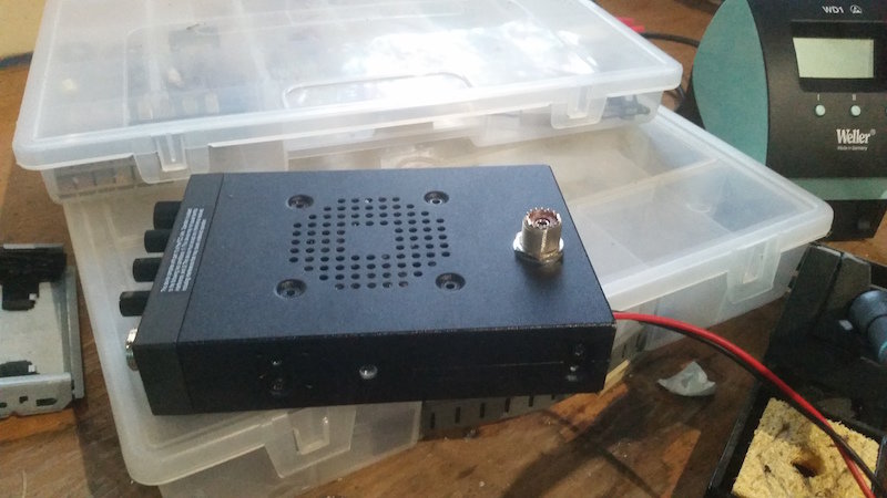

    Finally put the CB in the ashtray slot instead of wedging it between the seat & console. Couldn't find a low profile 90° uhf so I moved the panel mount onto the bottom; came out pretty flush.

    Damn dude that's an awesome idea. Nice work!

    No bump stops?
    I've got the U-bolt flip, there's some pics in the last couple pages of my build IIRC

    shit lol glad i checked here before i pressed order. although wouldnt i be ok with out them for at least a couple of weeks? as long as i dont go wheeling or anything like that just daily driving

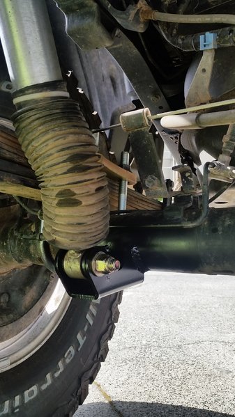

    I have the AP ubolt flip. They dont come with bumpstops and I had to modify the plate to use the oem ones. Also used shock tabs from wfo concepts. Turned out pretty nice. I used stock upper location with 10" 5125s. Wish the shocks werent so stiff because the dakars are pretty stiff but its not too bad..20160226_133058.jpg

    ok thanks. i couldnt afford for new bump stops so im either going have to use the stock ones or wait till next paycheck to get them. i think i'll be fine if i dont do anything other than just drive to work which is 8 miles one way. just didnt expect the bump stops to be $200 lol i could wait to install my coil overs and rear suspension but if im just careful i should be fine right?
