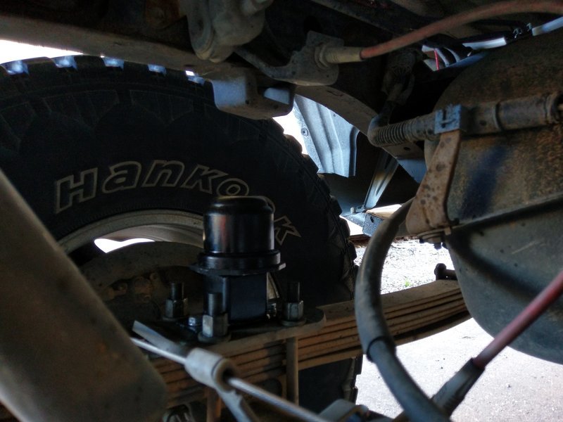

    Why not go to the junkyard and pull some bumps stops off of something there. Got mine for 10 bucks and drilled a hole in the rear bump stop pad (Got bumpstops with a threaded end) and used the u bolt plate as the strike pad.
    See triangle bumps next to the shocks on the frame.
    [​IMG]2016-05-06_07-54-23 by Harrison M, on Flickr
    j0shu4 likes this.

    If all you want to do is stop uptravel at a certain point that's a fine solution, but the superbumps provide a nice cushioned bump for those of us that like to go faster.

    These provide a lot of cushion. If you need more, drill some holes in it. Not a sudden stop or huge bang.
    EDIT: This is just an idea for guys on a budget. I personally think people are crazy for paying the price they do for rubber bumps. Have the triangles in the back and ones similar to superbumps and wheelers in the front. Work great for go fast(ish) and slow crawling. Fast being washes and faster trails. And dont break the bank at all.
