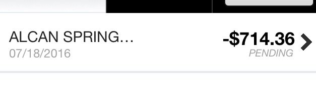

    Dam..dem ain't cheap

    Oh well.... It's done now.

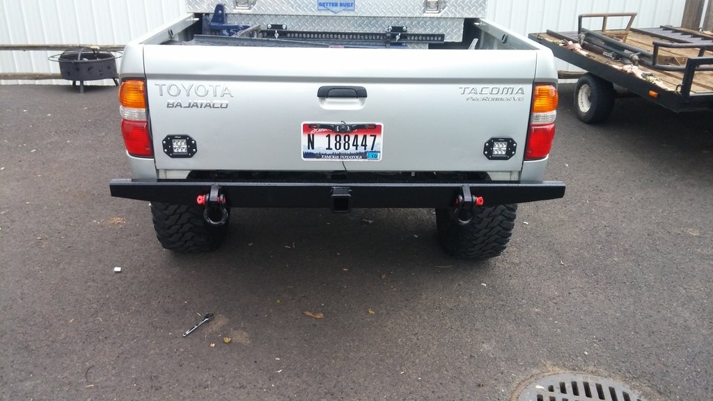

    i worked on a rear bumper for my pickup saturday night, ran out of time/materials but it will continue down the sides towards the tire once i cut the bed. its made from 2x4 tubing thats 1/4 wall with 1/4 wall c channel mounting it to the frame. should be plenty stout

    Simple but I dig it...kinda like what you did with those pods as well.

    Thanks! The pods ended up in the tail gate because i didnt wanna have to make two sets of holes in two different bumpers, and they seem to be more up and out of the way in the tail gate

    They almost look like they'd kiss the bumper whenever the tailgate is down.

    The gap between the tailgate and bumper when it's closed looks to be at least more than a inch or so. I bet it clears fine.
