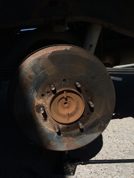

    image.jpg What's leaking

    Most likely axle seals but hopefully not lol

    How should we know? Take the drum off and have a look see, could be the brake piston or the axle seal.

    Your axle seal. Might be time for a new axle seal and rear wheel bearing.

    Well check your brake fluid res if it's low it could be your brakes. If the fluid has a terrible smell it's your axle seal. The seals are usually really good. If it's leaking I would bet you have a bad wheel bearing or a stuck breather. But in my experience a stuck breather makes the pinion leak.

    I just figured most of you know more about this stuff then me and had maybe seen it before.
    I still have the same about of brake fluid.
    Thank you.

    As an FYI if you need a new wheel bearing. It will save you a couple hundred bucks or so to remove the shaft and bring it to a machine shop have them install the new bearing. I would call your local Toyota dealer and ask them where they have their bearings done.(it won't be in house). I brought my shaft to my local shop it cost about $300 all said and done.
    It's actually super easy to do an axle shaft in these trucks. The hardest part is the brake cylinder if your brake line is seized. So if your comfortable with trying rear brakes you can change the axle shaft. The shaft only has 4 studs and even if you shear one off its super easy. Pound it out and through bolt it with a m10x1.5x40 bolt from the local autozone and your good to go.

    My closest "local" shop is about 2 1/2 hours away. I'm just gonna take it to a local shop and have them look at it.
