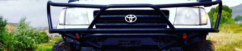

    Picked up a tube bumper off craigslist. Was originally for a 3rd gen 4runnner but it bolted up okay. Not bad for $150

  9. Jul 25, 2016 at 5:17 PM
