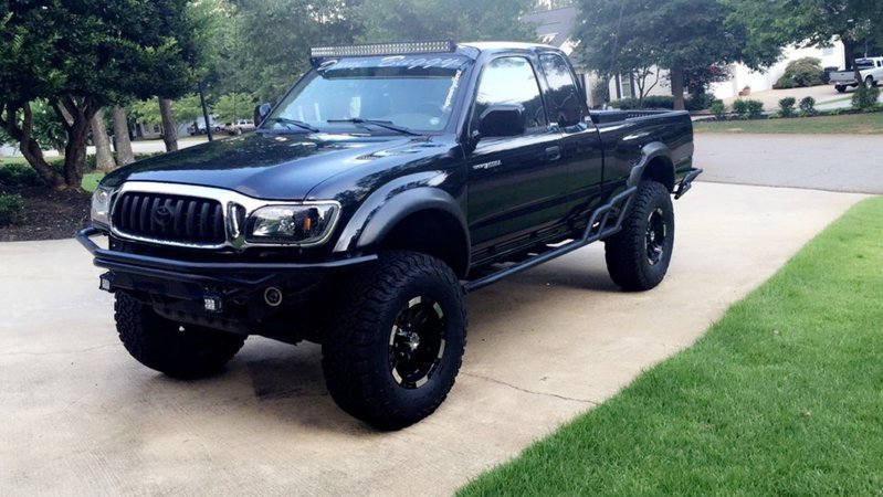

    -3in old man emu suspension lift with 882 coils, nitro chargers and rear add a leaf -1in Daystar Body lift -295/75 BFG KO2'S -flowmaster dual 40s
    New shoes finally 295/75 ko2's

    Like'em ;)...how's the rub?

    As long as I don't turn all the way to lock they don't scrub

    How about at full stuff? :wink:

    They barely touch the frame

    Yes, but what about the firewall?
    I've also had to clearance the top of my fenderwell, and the front edge of the fender. A little trimming in the front edge of the rear wheel wells too.
