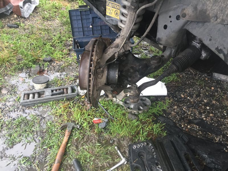

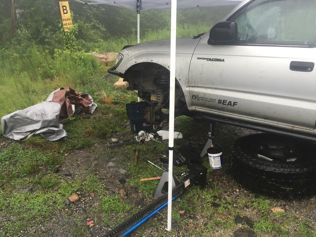

    Think I broke my spider gears at the offroad park in the front diff. Cut one of my cv's in half to get home the 2 hour drive. (Theory behind this was afraid the diff would lock up on the highway since cv's still spin.) Had to do the work in a downpour so that wasn't fun. I can't afford new gears gears for a bit so I am going to disconnect the front drive shaft, change the oil in it and run it like that for a while.

    Sorry to hear that, man. What sort of obstacle were you on when you busted the spiders?

    This but going the opposite direction.
    Got up that first ledge and bumped the rears on it and spun to try to get it up, couldn't and backed out.
    Went to go on a tighter trail and hard turns made a popping sound in the front end. CV's are fine so assumption is front diff.

    Strange but not unheard of. If you put an Aussie or lock rite in you won't need to worry about spiders. Just buy CV joints with lifetime warranties.
    Edit: you inspected both CVs? If you blew apart the bearing cage in the hub end the boot would probably be attached still. With an open diff you wouldn't really hear much noise.

    Planning on going ARB front. Just trying to figure out what I need to do to be able to drive for a couple months while I get the cash for the regear and front locker.
    Anyone with more experience please chime in.
    I am thinking leaving the passenger side CV in and in tact. Since ADD tube is disengaged it shouldn't turn the gears in the diff. Since I have no shaft connecting the drivers side nothing is spinning the diff there either. And since both of those are disconnected the front drive shaft shouldn't spin either, correct? I can confirm that by trying to spin it by hand now, or video it and see if it moves when I move the truck.

    Your fine. As long as the outer stub shafts are in the hub and axle end you will have zero problems. I have run mine with one or both of the CV shafts missing numerous times.

    You pulled the driver shaft, assuming your disconnect is working your correct there is no issue.
    The only thing I would be curious of is you broke the hub side bearing cage on your passenger CV. The boot would likely stay attached. Most of the CVs I have broken the boot doesn't disconnect and the CV looks fine it grinds and the boot simply spins on the outer stub. Once in 2wd the sounds would be light and possibly not noticeable. Iv heard of open front guys wearing spiders out on larger tires but pretty rare. In my personal experience I blew a rear ring gear on 33s after abuse for a few year but no issues with the front. I have since referred and ditched the front spiders so I may not have abused the front enough to have that type of failure.
