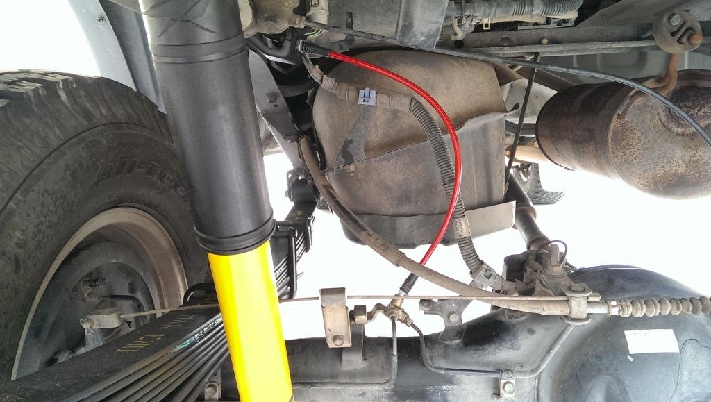

  18. Jul 31, 2016 at 10:34 PM
    Delta00
    Delta00 ᕕ( ᐛ )ᕗ
    Sep 16, 2013
    #112633
    4,137
    Troy
    Chandler AZ
    2002 Toyota Tacoma 4WD
    Check Build
    Like this, red is new and what was replaced.
