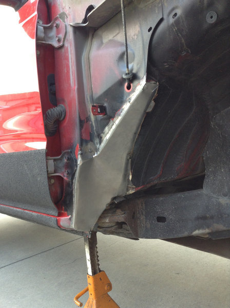

    First of all, thanks a ton to all of you guys that answered questions and provided input. I'm not done yet, by any means, but I'm past the worst part (I hope).
    315/75R16 Cooper ST Maxx. FWIW, it does say on the sidewall '35" OD 12.50 SW'.
    I've heard of more than a few people rubbing after they tub the firewall. It's a shitty, shitty job; so I wanted to make sure that I didn't have to come back and do it again or deal with rubbing after all of that work.
    The key to what I did was using cut down bump stops that I got from @TimF. They helped a TON. In fact, I have pictures of the final cuts with the 'half bumps' and with the 'full bumps', and you can really see the benefit of going a bit further.
    Like I mentioned above, mine 'say' 35 OD and 12.50 SW, but I'll have to actually measure them sometime.
    ETA: Also, just like Monte said there would be, there was pretty decent frame rub at full lock with my 3.5BS F5s. My BORA spacers should be here in the next couple days, so we'll see how they affect things. I tried to take enough of the rocker section out to account for the added inch of protrusion. Just something to watch for for the next guy.

    FWIW when we got our center line cut, we massaged the thin part of the firewall a couple inches back on each side of the cut. This made the firewall move back while closing the gap and not needing to fill as much. The biggest concern I had was making sure I cut as far back as everyone did on the rocker section since once it's tubbed you cant really hammer that much more.
    I wheeled a full day this past weekend with no rub before I broke my spiders so I am assuming I cut enough.
    I do however definitely think cut bumps would have made me have bigger holes too.
