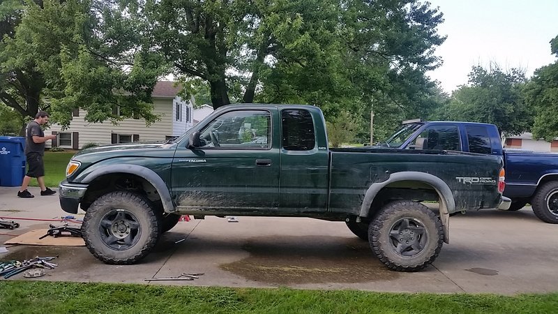

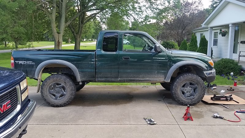

  1. Aug 2, 2016 at 7:51 PM
    Cohbsteq
    Cohbsteq Hood Rat
    Oct 27, 2013
    #115350
    4,316
    Jacob
    SL,UT
    02 Supercharged 4x4
    Pretty much stock with some crap welded to it.
    I just ran two the parts store and picked up a multi use bulb housing? I think it's probably called something different, but it's just a self ground socket with two power inputs one for the blinker and one for the running light, super easy to install I just had to trim around the back of the corner lights.

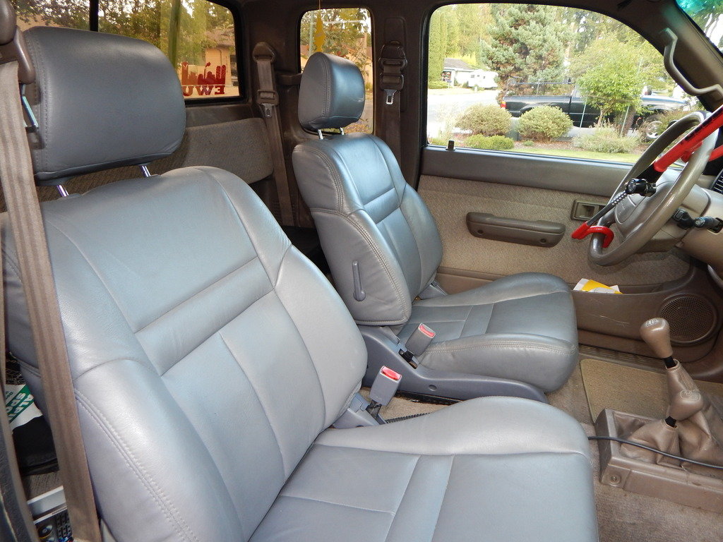

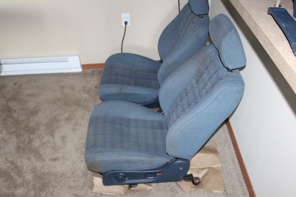

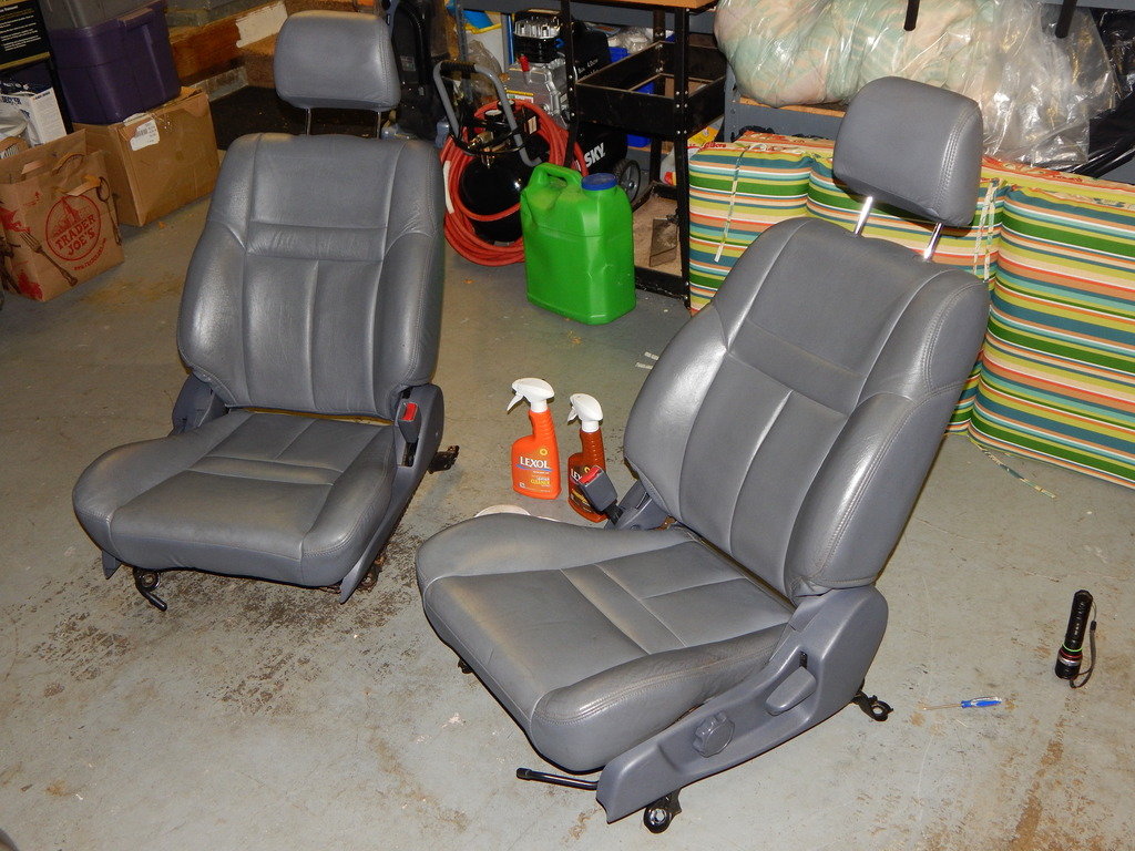

    Sooooo, like these....
    or these...
    I might have done a few seat swaps.... what do ya need to know?

    Both of those are good. I'm just tired of these 60/40's and wondering how hard it would be.

    If you can weld, it's pie. Got the leather ones done in an afternoon before work. If you cannot weld, then you'll need to find 3rd Gen 4Runner seats or seats from another 1st Gen taco that are single. You can play rail swap on the 3rd Gen runner seats and make em fit or cut and weld like i did. Keeping in mind that the rail on the 60 side of a 60/40 is lower on the seat than on a single seat so if you weld that mount on it'll have to shimmed up a bit to be level. I can explain this with more pics and better wording if needed.
