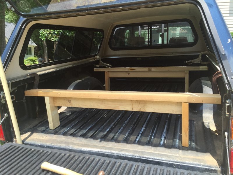

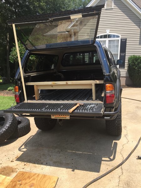

    Getting the frame work laid out for my storage/sleeping area

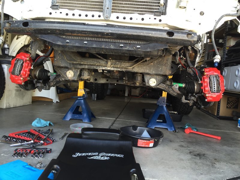

    Out moth the old 4.10 open diff and in with the new 5.29 and ARB :D

    Do you plan on just putting a 3/4 plywood sheet over

    For right now yes , I would love to put a cargo glide in but that's gotta wait

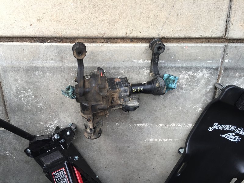

    Got the old one out!

    Anybody have any tips for removing the ADD tube from my old IFS clamshell? I don't want to screw up my core of the ADD that needs to go on my new diff.
    TIA

    What is that?
