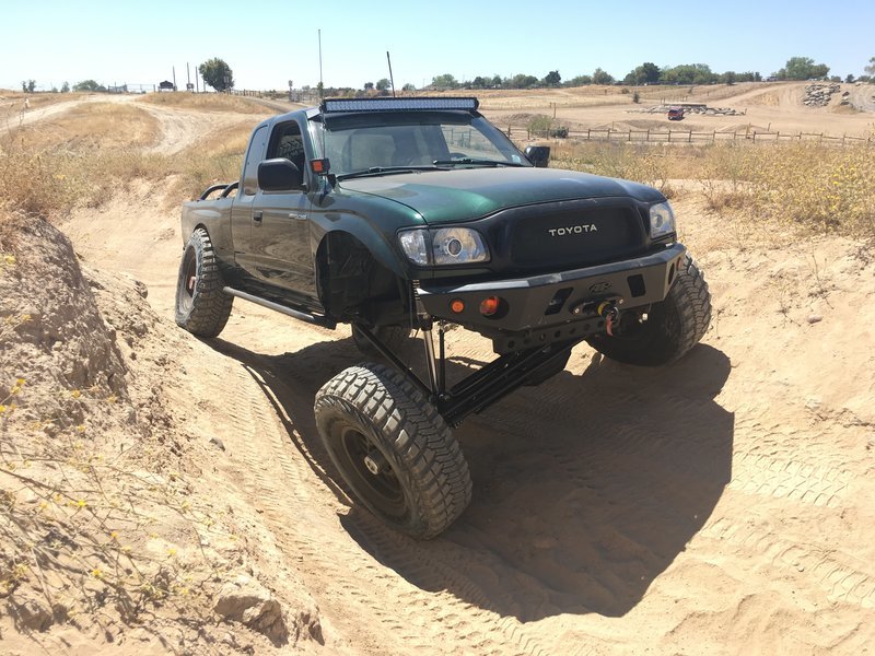

    That thing is sexy AF, Jimmy! Glad to see your patience paid off!

    i want your truck.....please....

    God I love this machine.. Ill take two please
