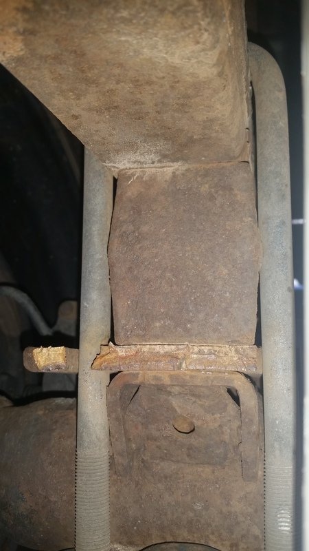

    Factory leafs and 37s was probably a factor aswell...

    Jun 2, 2015

    53,028
    Utah

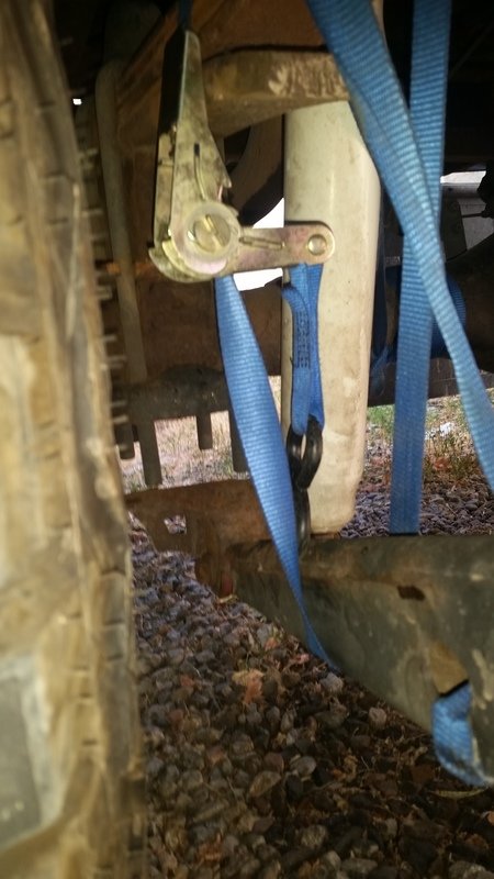

    More importantly, where was/ what trail was this? I see you're in SLC and I plan on going to school out there somewhere within the next year or so. It's a good question.
