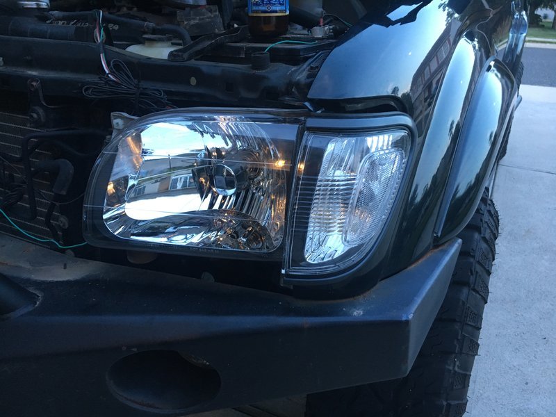

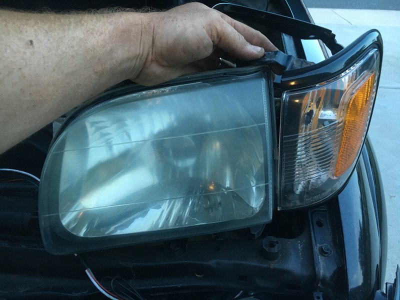

    Put new headlamps and side markers on lil Kim.

    Love those. Where'd you get them?

    Yussss What's up homie?! Looks good!

    https://www.amazon.com/gp/product/B008G32B1O/ref=oh_aui_detailpage_o00_s00?ie=UTF8&psc=1
    I bought the side markers off a member on here last year. I finally installed the damn things. I had to drill a hole to insert my blinkers in them. Now I need to figure out how to stop the hyper blink.
    YOO gangstar. lil kim needs help seeing in her older age. lol

    Go to your local parts store and all you need to buy is a different blinker relay that supports led's. I forget which one it is. Its just plug and play though...takes like 10 minutes.

    Isn't it amazing what new, non-clouded lamps do? It was like night and day when I put mine in.

    Should of been the 1st mod instead of waiting this long. My old lamps looked like dookie
