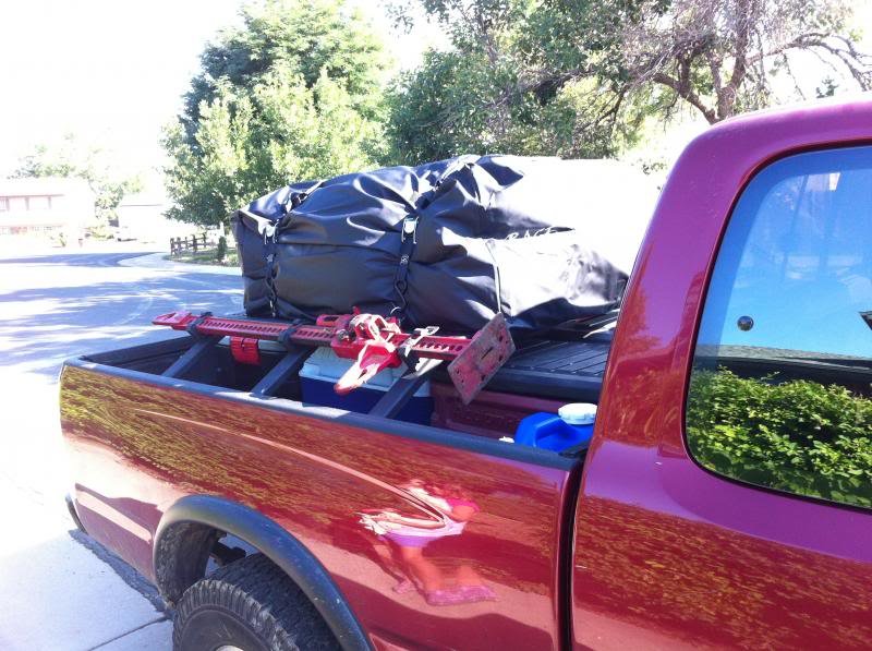

    Hi Lift

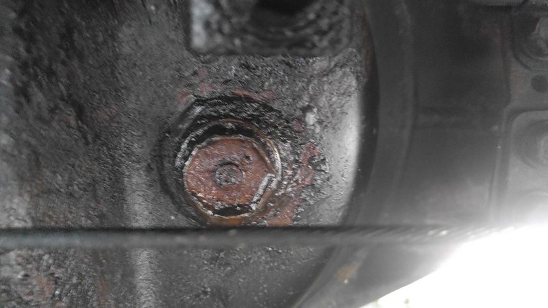

    Anyone have advice on how to get the fill plug off the rear diff? It's not in the best shape (drain plug looks excellent somehow) and it keeps going to strip. I already did the trans and t-case today with very minimal difficulties. The front diff was a 5 hour long worst-time-I've-ever-had-working-on-anything nightmare of a job but it's done. All I have left is this rear diff and of course, I have to deal with shitty stripped bolts. I'm losing resolve. Any help is greatly appreciated.
    Edit: this is the awful state of it

    Buy a new fill plug. When you have it on hand, go to town on the old one. File down the flats and use a set of vise grips.

    I think those are both good ideas, especially getting a new one FIRST.

    If I had equipment/knew how to weld, I would definitely. Unfortunately, I have neither of those.
    But I will definitely be getting a new plug.
    Yeah there's no way I'd bother to get this one out without a new one. As for removing the old one, vice grips was my first thought. But filing down hadn't come to mind. That might be a big help. Thanks for that one.

    You need to consider that rear lift springs/pinion angle shims can rotate the housing. Typically this moves the pinion end up and the fill plug down. This defeats the "fill to the bottom of the threads" thing. It is also why different model trucks with the same rear have slightly different listed gear oil capacities to get to the "bottom of threads".
