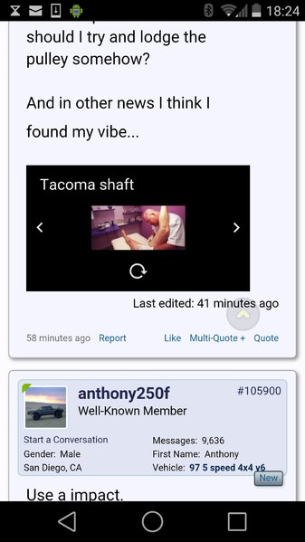

    What I really want to know is WTF next vid that pops up after yours plays. I took a screen shot, but am way too afeared to play it.Screenshot_2016-08-27-18-24-20.jpg

    Ummm... Yikes.. Hahaha wtf!!! I guess it was the next video labeled shaft..
