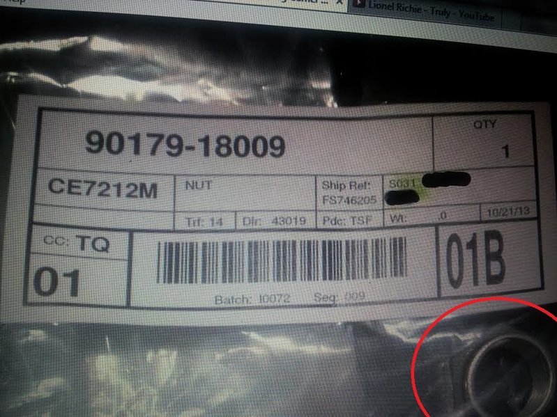

    Yeah, that's it. I think I paid 147 for it. Looks like it went up in price a bit. Same part #, I double checked. Here is the nut that is recommended you replace with the old one. I got it from Toyota but they may have it on this website too.

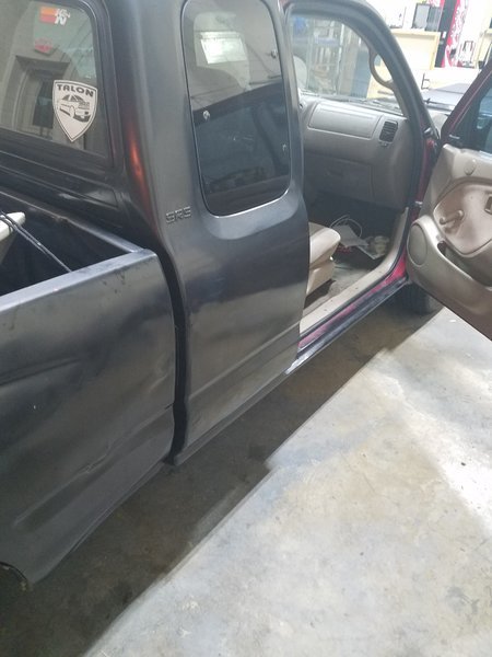

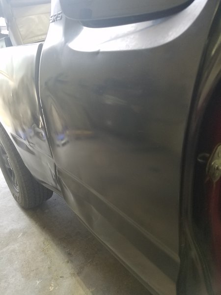

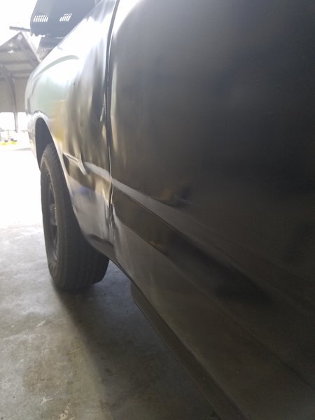

    Pulled dents from a accident on the passenger side of the cab. Done by previous owner. Cleaned 16 years of Alabama red dirt road out of the parts I removed for the dent removal.
    Pics are before, and during dent removal.
    Then water before and after cleaning two seat belts.
    Last is the final product of the dent removal.
