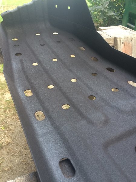

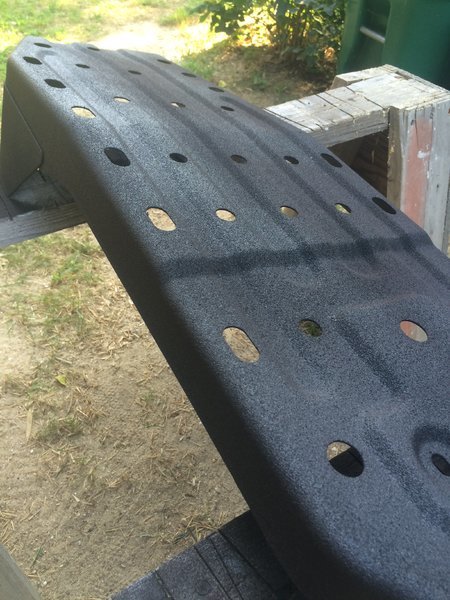

    Yeah the skids did hurt the wallet but was the last thing to replace. Camelback saved me a bunch of $ on oem parts. I'm going to have Krown rustproof the truck. They started in Canada and came to the states. I found them on the net and talked to folks who swear by them so I'm gonna give them a go. They inject in the body panels and inside frame also. It's a once a year thing but if it preserves my newer frame and parts I'm gonna try it. My truck has 98,000 miles so should have a lot of life left in her.
