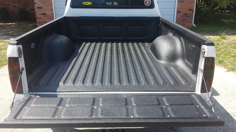

    Thanks guys, just a little trick I picked up from the youtubes. Still doesn't protect the tire as much if you aren't very good at coloring between the lines like myself lol. File folder strips sound pretty clever too

    That's one of the things I wanted to protect was the tires, was doing my new Audi Q5 wheels. the strips were long enough to go halfway around the tire and I also did the same thing on the back so I could do the inside. both strips met on the tread where I taped them down.

    I was quoted around 550 to do mine without the UV coating. Figured I'd give it a shot and do it myself since I'm cheap and wound up costing me around 170-180. If I had the cash I probably would have paid someone but in the end, I was glad I'm cheap. lol
    If I ever do it again, I'll know the in's and outs of doing it faster and better.

    I'd like to kick the person in the nuts that used a DIY bedliner kit in my Tacoma. I"m not a fan.

    Not sure what you're referring to? I said the drop in bedliner caused the problems, the Herculiner I put on myself came out great. Drop in bedliners are a pain because they trap all kinds of crap underneath them (including water that can lead to rust), and the scratch the hell out of the paint.
    Did they do a crappy job or something?

    It looks like they did a good job, but the last two Toyota trucks I had I had them done in LineX and it looked so much better. If there was an easy way to get this stuff off I'd have it redone in LineX next week. I'm half tempted to find another bed and have it painted to match before LineXing it

    Damn, you really hate DIY bed liners huh? haha, it's cool...to each their own. I like the utilitarian look and feel of it, matches the aesthetic of my truck and the direction I'm going with it. Is there even a hard way to get a DIY bed liner off? They seem pretty permanent.

    All of it has to do with the person putting it in. You can make it look just as good as line-x

    Previous owner put in garbage spray in bedliner and its flaking and looks horrible. Anyway to get it off completely to re do it right with line-X?

    If its the cheap roll on type liner, acetone or lacquer thinner.
    Might as well buy 5 gallons, soak a bunch of old towels in the thinner and let it eat the old liner coating. Put dry towels over the soaked towels. It slows down the evaporation of the thinner.

    Agreed. Lacquer thinner and this:

    Either this or get some jasco paint stripper, it's easy to apply and works awesome but will take your paint off so be careful.
