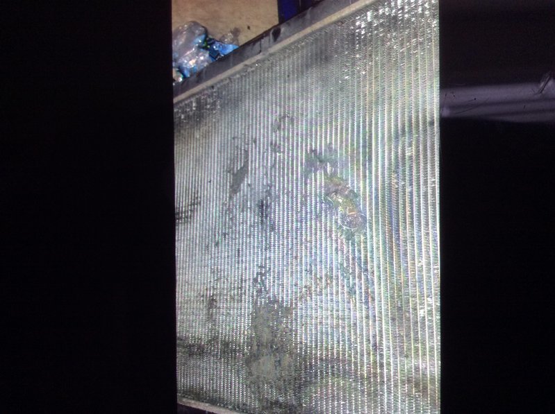

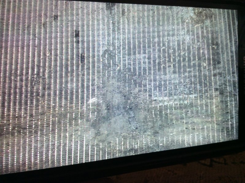

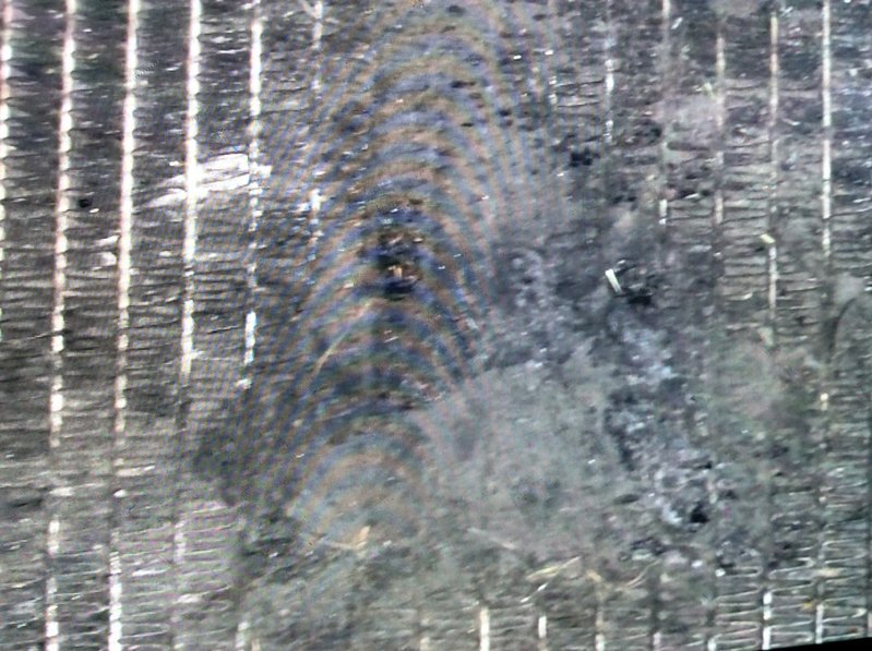

    So my fan clutch would not disengage, sounded like a vacuum cleaner all the time, so I replaced the fan clutch and still did the same thing sucking all my power, decided to take the radiator out and guess what, behind the AC condenser, the radiator was packed with
    mud and dirt, bugs, leaves, you name it. I couldn't see any of this until I pulled the radiator because of the AC condenser covering 3/4 of the radiator, now runs even better,
    Guess after 503,000 miles it time for a new one anyway, ;)

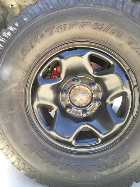

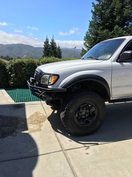

    Tundra brakes are done! Bedding in process was fun. Few neighbors think I've lost my mind driving up and down the main road.
    And my oem home brewed knockoff 5 stars are painted. Looks waay better

    Paint the center of your hubs?
