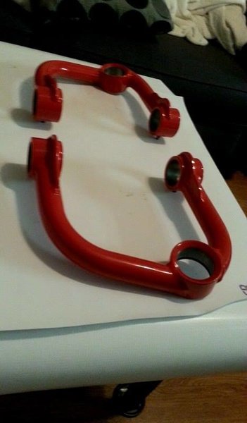

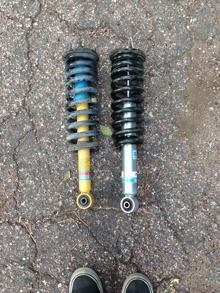

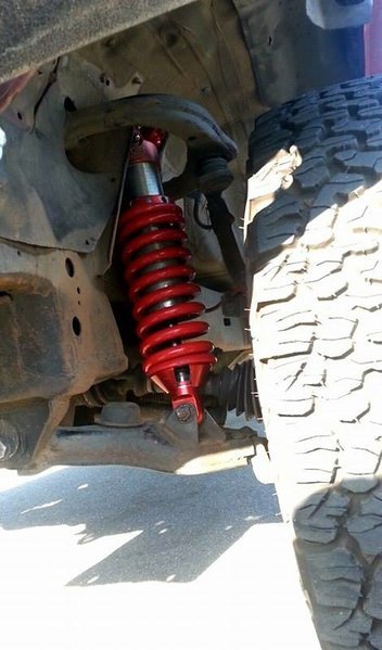

    Installed my new to me coilovers, Thanks again @SCRunner12 . Picked up my UCAs from powder coat shop, waiting to install after I get my complete rebuild kit. Alignment scheduled today, so time will tell how soon I have to install them. I also need to adjust my rear shackles once more to get rid of the SoCal lean.

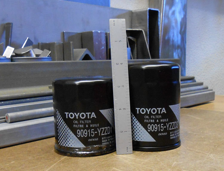

    I have both a 4.0 and a 3.4 and wanted to "stock" just one filter. I found the extra length of the D3 on the 3.4 made it more of a pain to get a filter wrench in there due to the factory oil cooler lines. It wasn't worth the maybe 2 oz difference.

    Good point, and thanks. I had to pull the fender liners to do my tubbing, and I was going to make the new ones removable on the frame side so that I can get in from the side. You think that would help, or again, not worth the extra capacity? This will be the first oil change for me, so I'm relying on my 1st gen brethren to drop some knowledge!

    It's going to be your call, your knuckles. If you don't have the oil cooler it's a non issue and still, personal taste.
    For me, being able to buy one filter size in bulk would out weigh the minimal difference in size but that was a no go.

    I can unscrew my filter through the fender well, but I have a 4cyl and it hangs vertical with decent clearance.

    I used to go from the fender but now I go in from under..It's easier for me.
    I wear XL gloves and my hand doesn't really fit anywhere near the oil filter...the extra length of the d3 makes my life easier to screw the filter on and off.

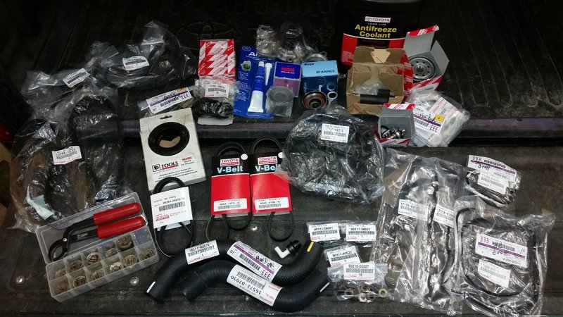

    It has been awhile since I turned wrenches. This should satisfy the itch for awhile.
    All but the radiator hoses, coolant, cam plugs, and timing belt cover gaskets (and tools and shims) came from Toyolexparts.Com . Their 52 piece kit was on sale for $466.43 a while back. For OEM parts you won't find a better deal.

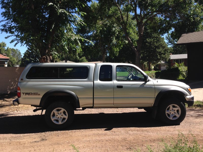

    Installed Bilstein 5100's all around and got a solid 2.25" lift out of it using my stock coils. Also leveled out the truck. My pictures aren't the best but you can see the difference.
    Before
    After

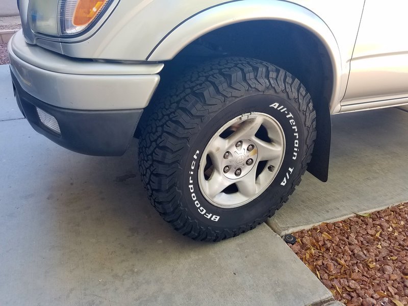

    Well I have a 2nd Gen... But today I put new shoes on the wife's first gen.
    BFG KO2.. looking good

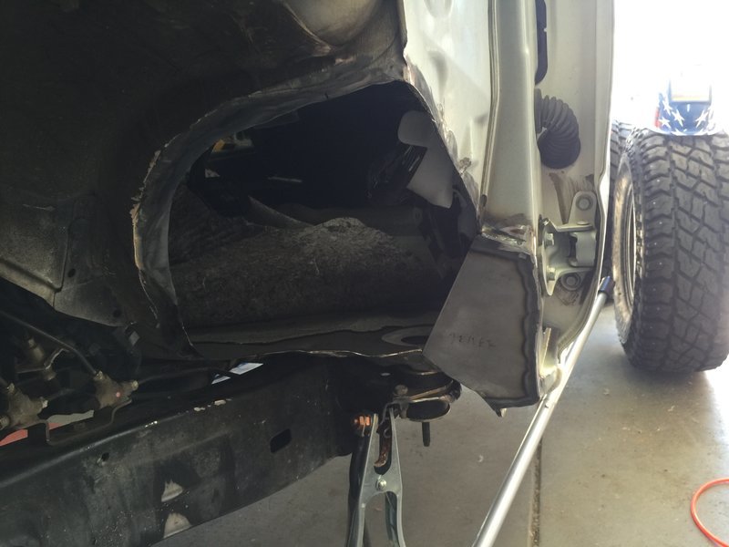

    Got a little bit of the welding done on my tub job! Only had a few hours, but it's still progress!

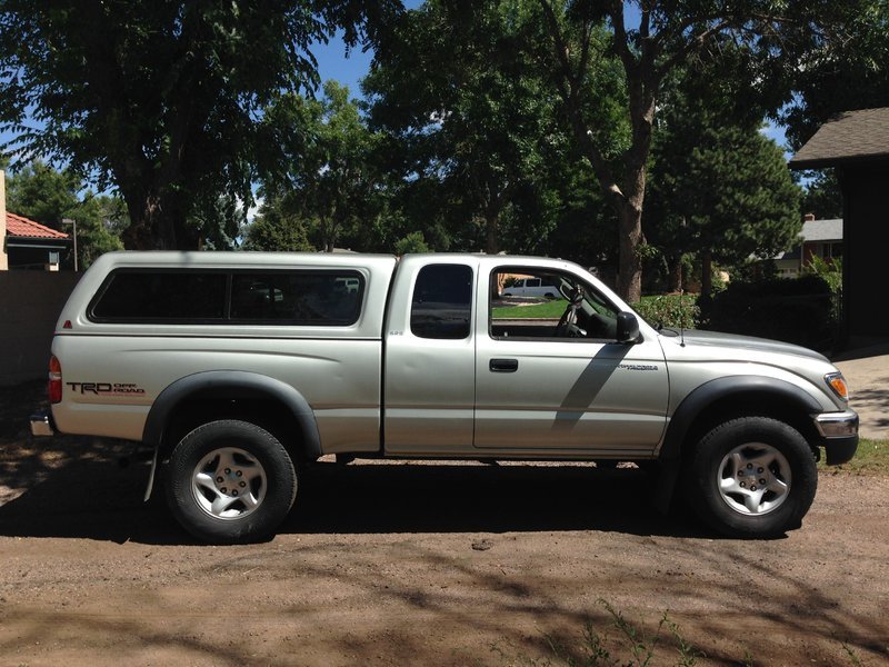

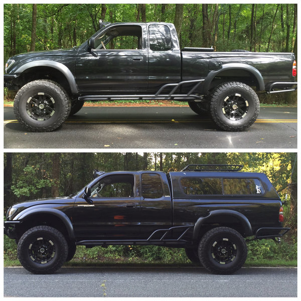

    Not sure what I like better the camper shell or just a tool box

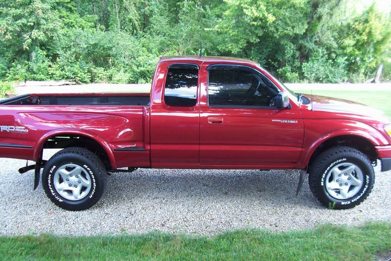

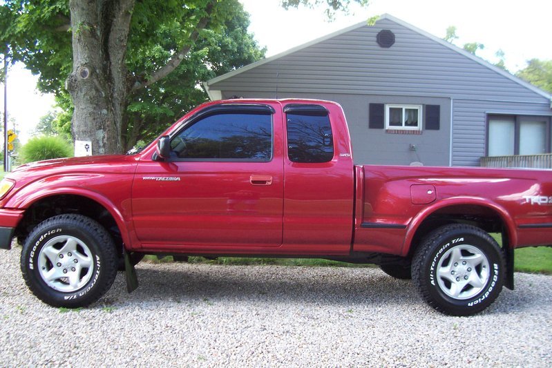

    Cleaned up the old girl this weekend after having it sprayed with krown. They did a thorough job of spraying that stuff. See how it looks after a couple winters of salt on the roads. Cost 175$ once a year to get sprayed.

    Not a bad price
    I just did mine myself with Waxoyl and Eastwood and that included the internal parts of the frame rails. I think I had about $80-$90 in materials.
