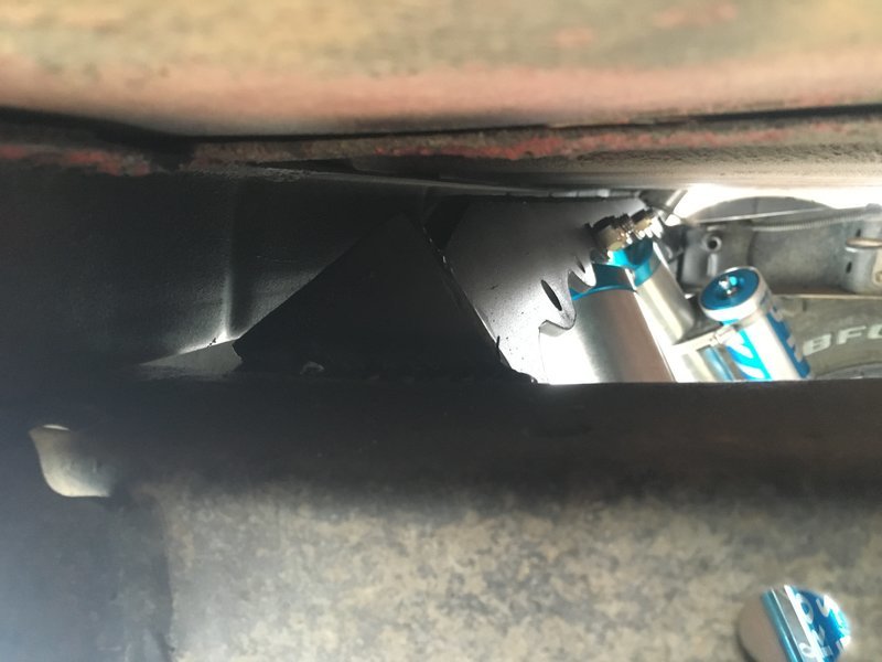

    Used the bamf relocation for first gens but did a descent amount of fab work to get it where I wanted. For the crossmember to be all the way up (almost touching the bed) the frame plates included didn't work for me as half of the crossmember would be above the frame... had to plate the ends of the crossmember then weld the bottom half of them to the frame plates and gusset the top. (pics later in case this was confusing)

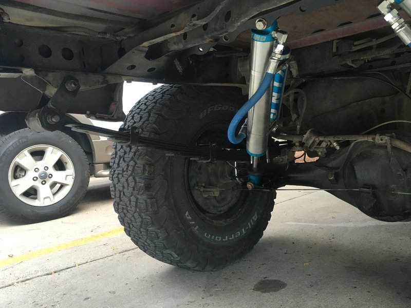

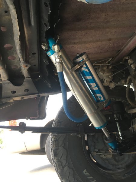

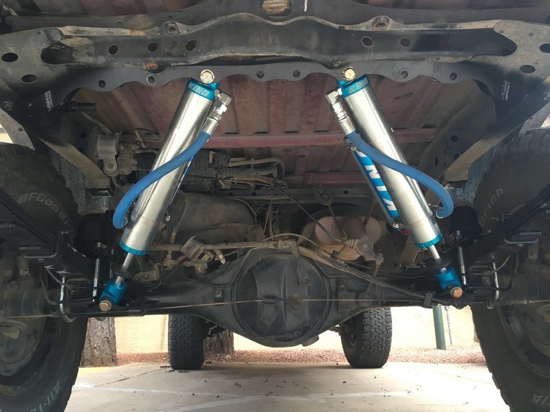

    Pics for @quetzal & @a.smo ... image.jpgimage.jpgimage.jpgimage.jpgUptravel looks small in some of the pics but it's just the camera angle...

    That's awesome! Thanks for the pics. I'll most definitely need to cut out the rear cross member.

    To run 12s properly... yes you will:sawzall:

    I'll be doing lots of cutting and grinding shortly. I also have some frame plates to weld up. How much shock do you have showing at ride height?

    I have 4in shock shaft showing at ride height with a 33" tire and a hi-lift in the back. At full bump i have about a little over 1/4 shaft showing and at full droop i have about 9.5" showing at that angle.
    Worked out pretty well for me being able to use the whole shock pretty much
