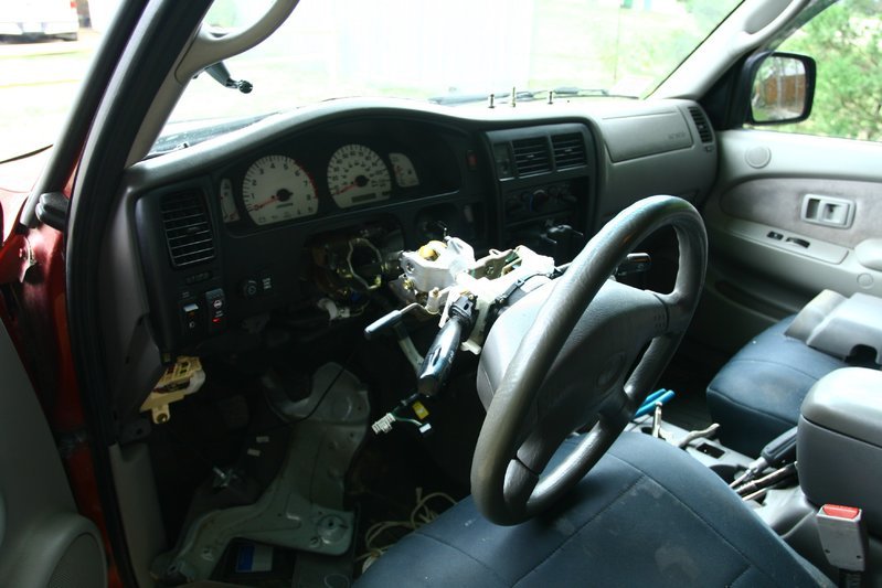

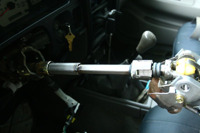

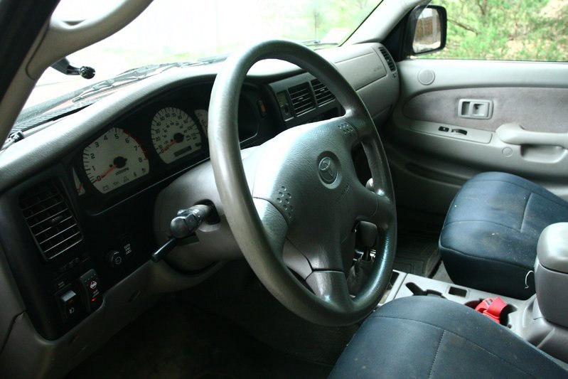

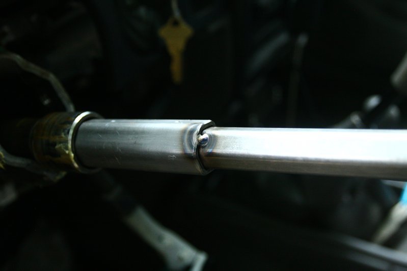

    Finally got the steering-wheel-slop mod done today .... couple tacks and hopefully I don't get punched in the chest by the steering column in an accident :anonymous:
    Feels friggen amazing though, much more solid response and the coin-jar rattle off road is gone :bananadance:

    Eh in my tacoma got in a front end collision. Probably get totaled out anyways and Id rather bet dead then anyways:p

    my feeling exactly :D plus I think the death wobble above 65 mph was getting me closer to an accident anyway :cool:

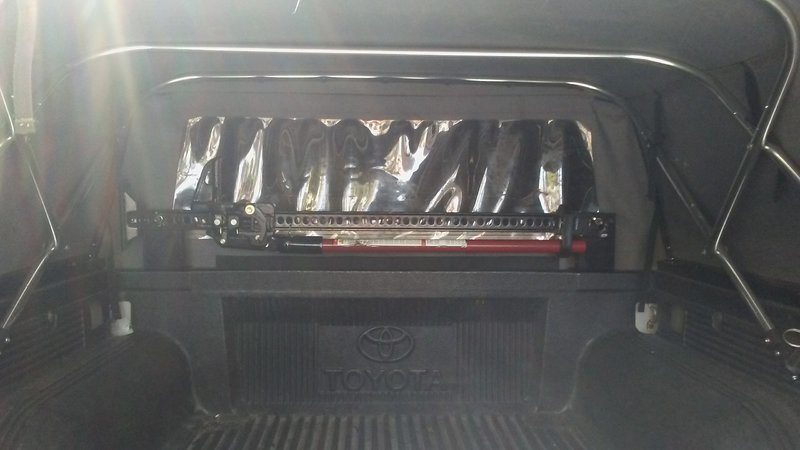

    Finally mounted my highlift

    Looks good. What kind of mount is that?

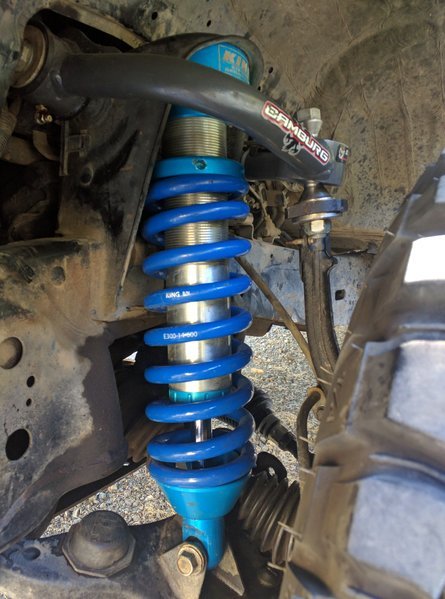

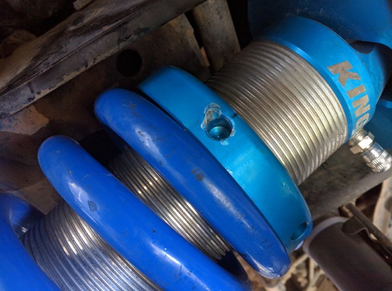

    Attempted adjusting my kings to compensate for the taco lean. All I accomplished was this. Fug. These are way harder to adjust than I thought. What the hell do I use? The uca is right in the way of the holes when the front end is lifted in the air.

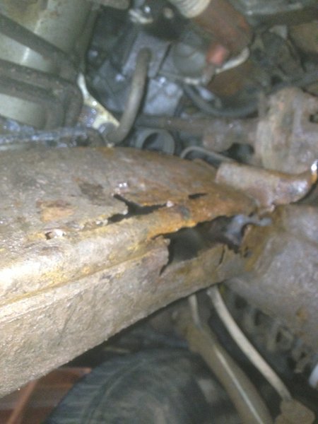

    Time to do some frame work...

    Did you loosen this first?

    Yup.

    Custom made by a member on here....i deleted my conversation with him so i forgot his user name...im sure he'll chime in......great product. I stuck them up high so i can have more space for my camping gear
    I put the jack under my lca and dont let it droop. But i also dont have aftermarket uca's

    You use a spanner or a punch?

    I had to take mine out/off. And it was still a pain.

    Jack the truck up so the front is fully drooped. Then use a long punch. Takes some muscle. I usually bend the punch a bit each time.

    I used a punch....and alot of wd40
