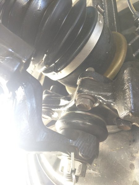

    Are these OEM lower ball joints?

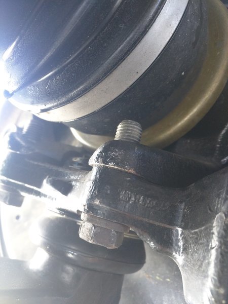

    Hard to tell from that picture. Look at the surfaces the bolt heads tighten against and where the OTRE attached. On an OEM joint these are nicely machined as opposed to cast like inferior joints.
    Also, looks like bolts were reused, that's another big source of failure. Get some new bolts in there.

    Just got it back from the shop last week and they are supposed to be OEM. Look different to me tho, don't remember the boot looking like that.

    That's because 01-04s have a dust boot that goes around the LBJ boot. It covers parts of the bolts too.
    Looks OEM too me
