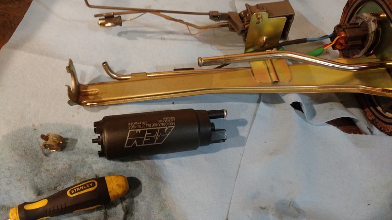

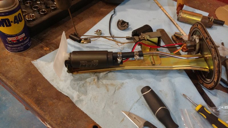

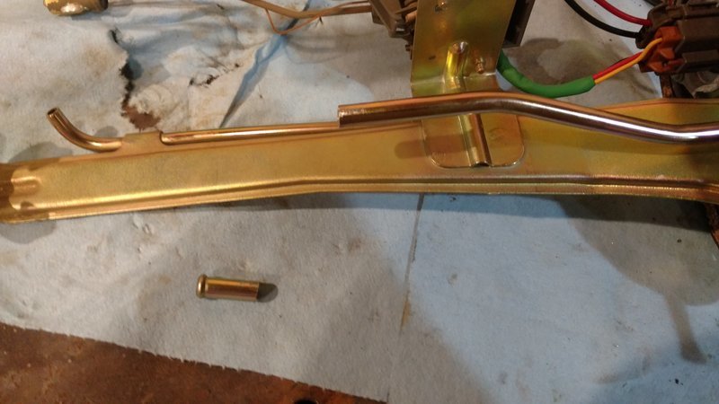

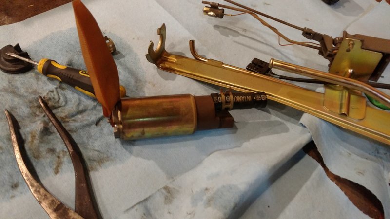

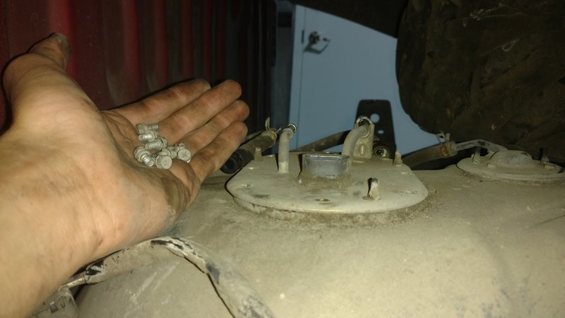

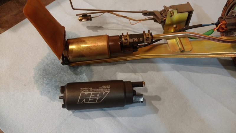

    Wastegate assisted turbo delete
    AEM 320lph fuel pump install (works for OEM just don't modify anything)

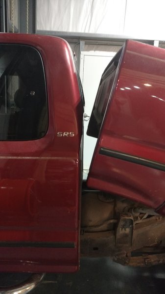

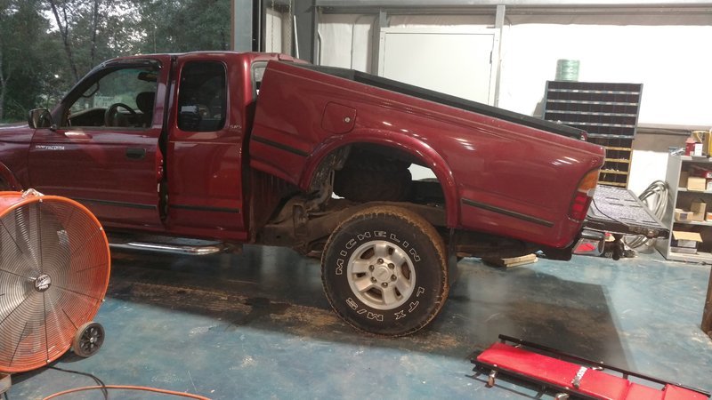

    Step 1. lift bed for fuel tank access (bed bolts 17mm x4-6 depending on model)

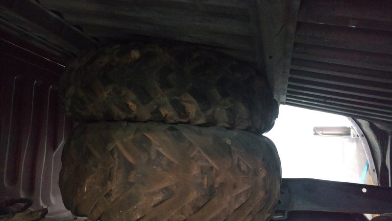

    Step 2. fourwheeler tires. (prop it up)

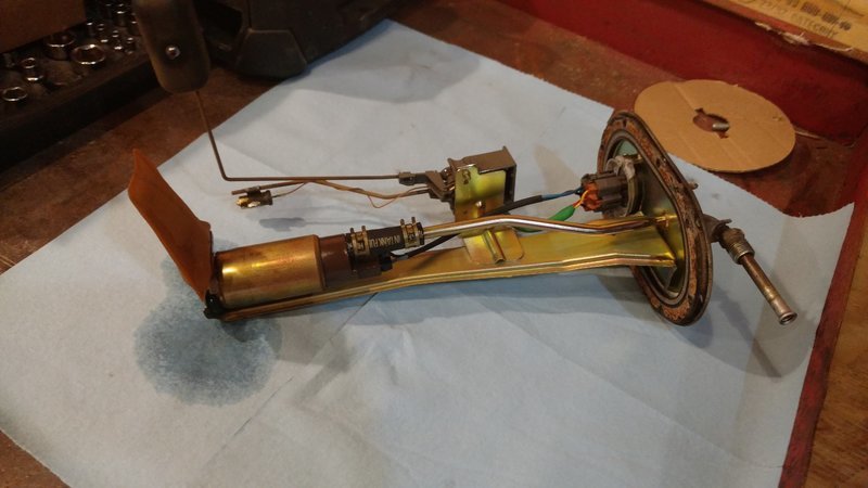

    Step 3. Assort and remember connector and pipe locations

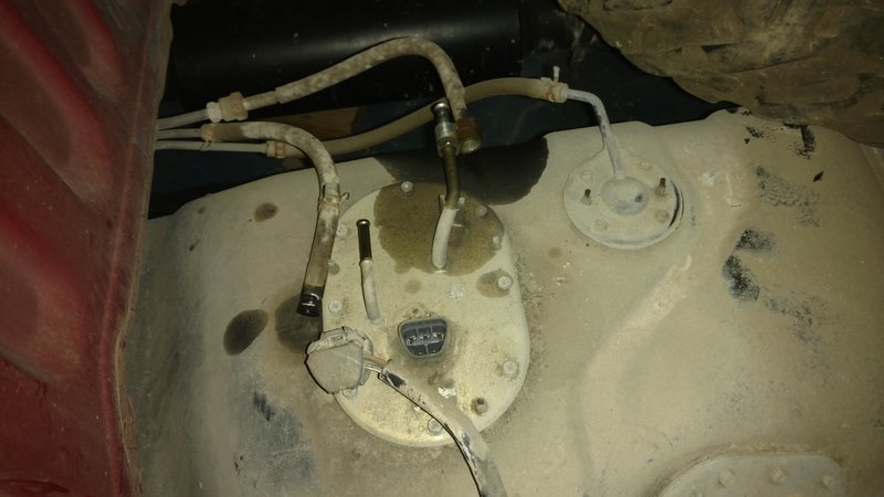

    Step 4. Undo pump bolts (8mm x8)
    Step 5. Here's what you're after.

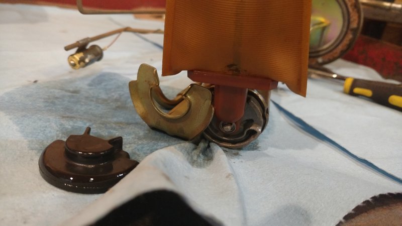

    New AEM next to smol Toyota

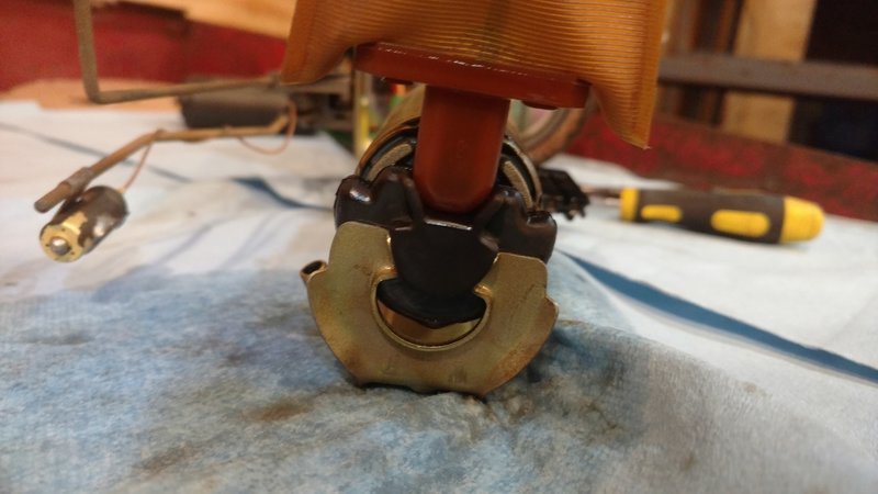

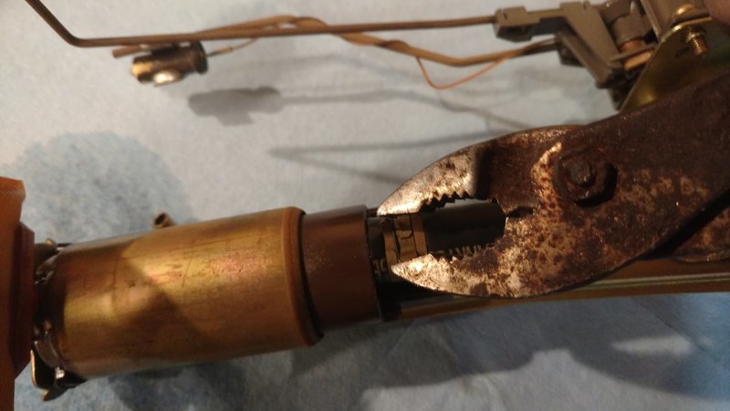

    Step 6. Undo this/these
    Step 7. wiggle pump from grommet
    Step 8. Fully remove smol Yota

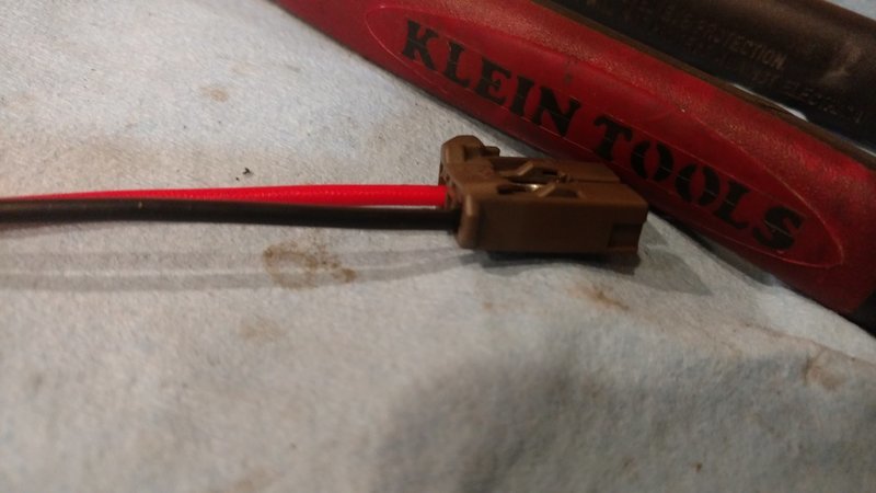

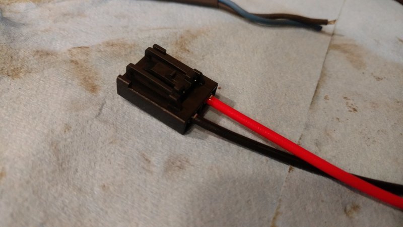

    AEM connector
    Step 9. adapt to Yota connector (I simply removed the Toyota wires and soldered to the left over crimps and shoved it all back into the plug) (AEM install only)
    Step 10. Modify pickup as necessary, and file down any burrs. (also blow through the tube to rid it of any metal dust) (AEM install only)
    Step 11. Install AEM to toyota connector and tighten worm clamps. (AEM install only) I had to modify the AEM grommet to fit the tacoma pump bracket.
    Step 12. Install AEM pre filter (AEM install only...obviously)
    Step 13. Reassembly is reverse of removal.
    Made it home, no fires!! :bananadead:
