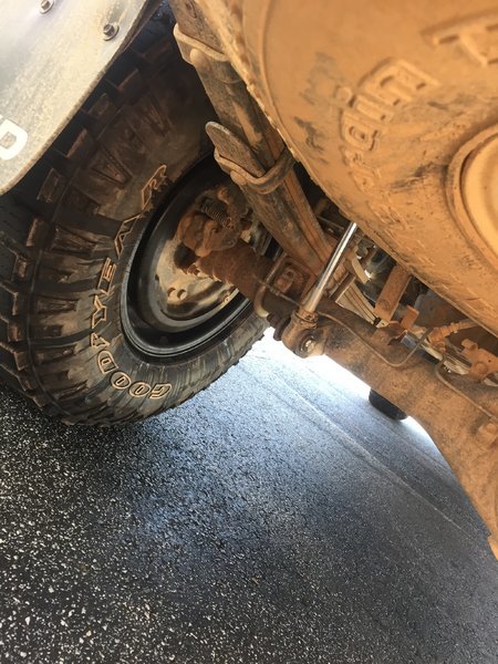

    Axle seal gone? It doesn't look bad but I've never had it

    Thats what it looks like. You'll likely need new brake shoes as well.

    x2
    And I wouldn't replace just the seals without doing the wheel bearings. Do it right or do it twice.

    Or the bearing could be the worn part, wither way do it all. Could also be the wheel cylinder too though so check to see if it smells like gear oil or brake fluid first.

    Damn I have to make a 600 mile round trip this weekend. If I bring fluid with me I should be good right?

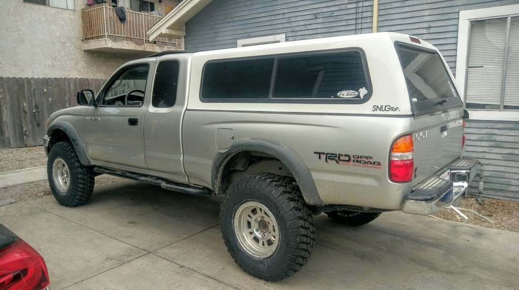

    Finally upgrade to real offroad tires. 255/85 on a 16x8 with 4.5" bs. Tires fit great, except the passenger side rubs at full lock. Actually, the wheel gaps between the driver side and passenger are off. Less clearance on the passenger side. Bent frame? Alignment? Rack (leaking)?

    Looks great!! I think the difference is due to alignment, mind is the same.

    Thanks bro, really appreciate all of your advice. I'm taking it to get aligned on Sunday morning. So far, I love it's stance and feel. 10x improvement over my worn down 265/75s.

    Lol yea you'll be good, I've had a bad seal for a long time now, I should probably fix that, just been lazy

    That makes me feel better, I don't wanna pay a shop to do it for me but I gotta figure something out. Good thing my commute is only 20 miles total.
    Uh I didn't know it was flipped, I bought the truck like that. It rides pretty stiff so that could be the reason. May look into that

    IMO, you are asking for trouble if you continue to drive it that way if it is the axle seal.
    If it a brake seal, you should be fine for a while. If it is an axle seal, the gear oil has washed the grease out of the bearing which will cause the bearing to fail. When my driver side seal failed, I barely got home (300 miles). Near the end it got loud and crunchy sounding with an ominous rhythmic vibration. YMMV.
    Having had that experience, I would never knowingly plan for a long trip without fixing it first.
