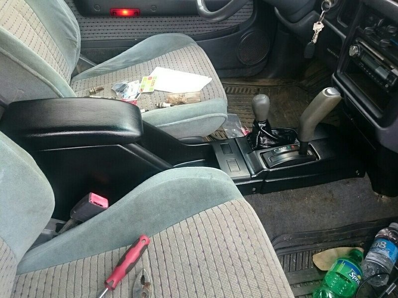

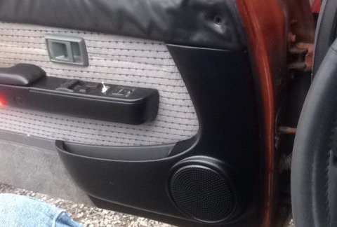

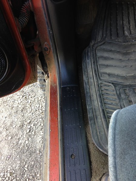

    Only ones on my phone. Note the door trim bits are spray on bedliner.

    That's exactly what I'm looking for! Looks good man

    The duplicolor worked great on all the soft materials even the shift boot.

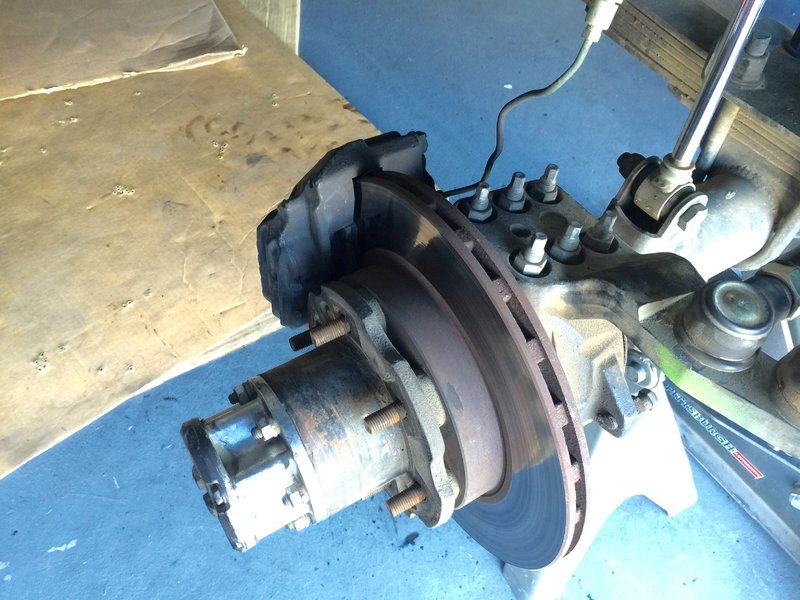

    image.jpgFront brakes replacement done

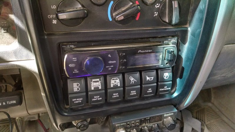

    Now I need to build the Bussman fuse box and pull my ABS computer so I actually have room in the engine bay for the new fuse box.
    Edit: Is the ashtray light wired into the dash light circuit or is it triggered by a switch when the ashtray opens? Just found that light and it would super convenient to power the LED's in the switches. I pulled the ashtray so long ago I don't remember if that light is part of the dash light circuit though.

    Tap the power from the flasher button. It's also dim able.

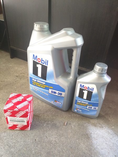

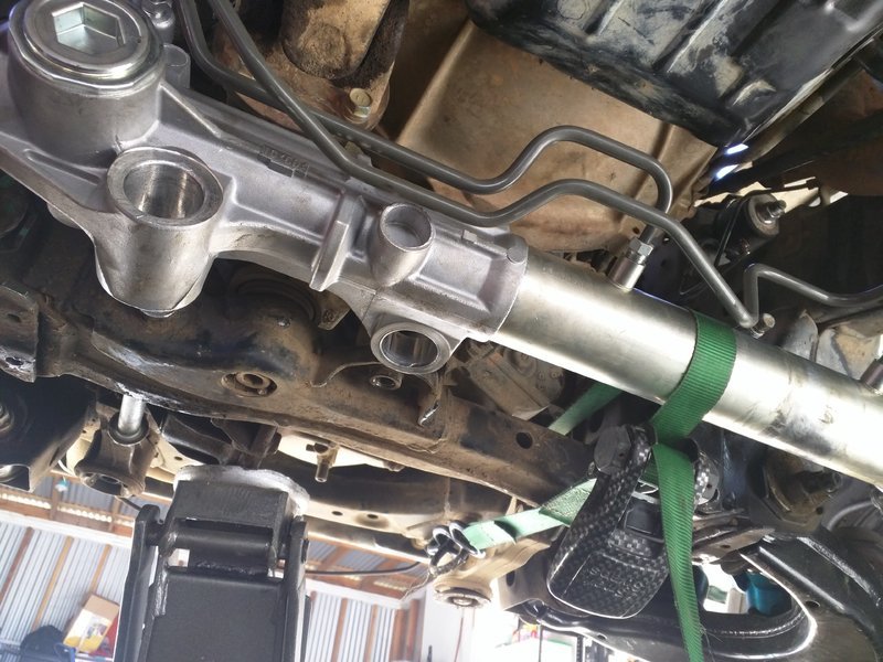

    Replaced steering rack bushings. Ate some candy from wheelers off-road. And changed her oil.

    Exact same oil change as mine :thumbsup:! Why is your rack so clean?

    Brand new rack, shop put it in like a week ago (insurance claim). Had so much play in it though. Much better now.

    How hard of a job was it? Im surprised you didnt get new bushings with the new rack.

    yes, facing the wrong way
    you have to take the right side rack bolts out, and loosen the middle and left bolts so it's able to rotate a little. otherwise you risk puncturing the boot as it scrapes out ;p

    Was thinking the same my rack is pretty toast and that one looks so clean! Did you go oem?
