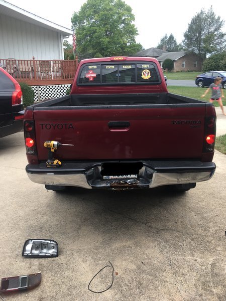

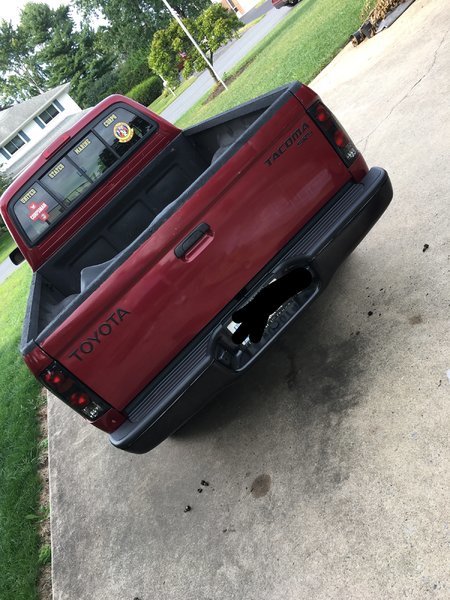

    Finally swapped out my old rusty bumper, decided to just stay with the stock step bumper but all black:bananadance:

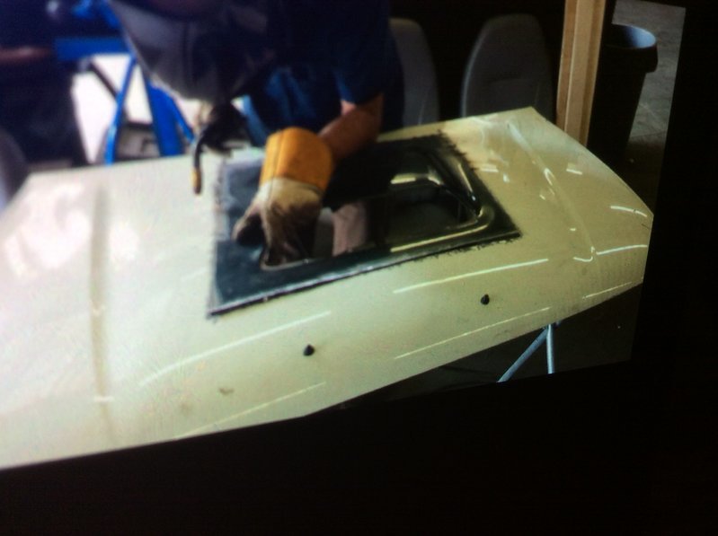

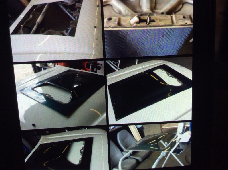

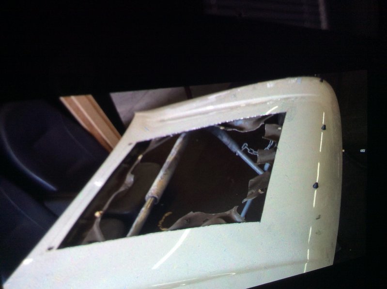

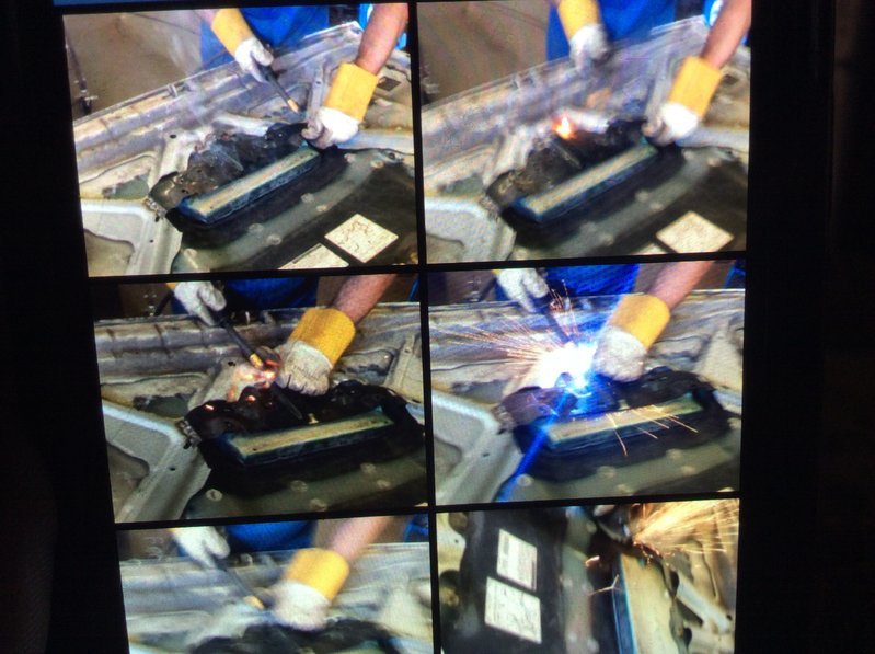

    TIME TO finally get that 4Runner hood scoop project stated. 2000 4unner scoop into 1997 Tacoma hood.
    SLOW AND STEADY,
