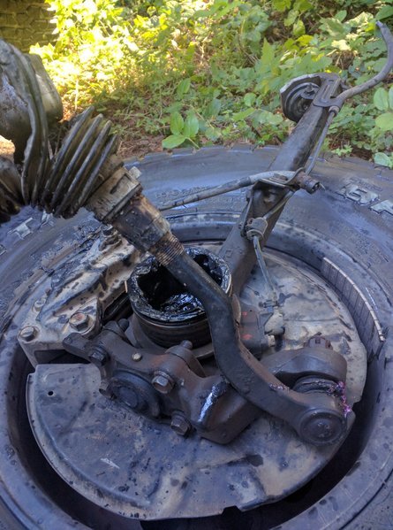

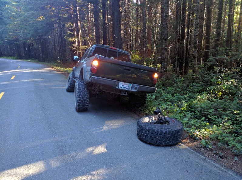

    Jesus. Is that the typical failure mode? Shearing right the fuck off?!
  5. Sep 21, 2016 at 7:21 PM
    anthony250f
    anthony250f Well-Known Member
    Feb 18, 2012
    #73066
    16,772
    Anthony
    San Diego, CA
    2008 dcsb trd offroad 4wd
    Yup..scary

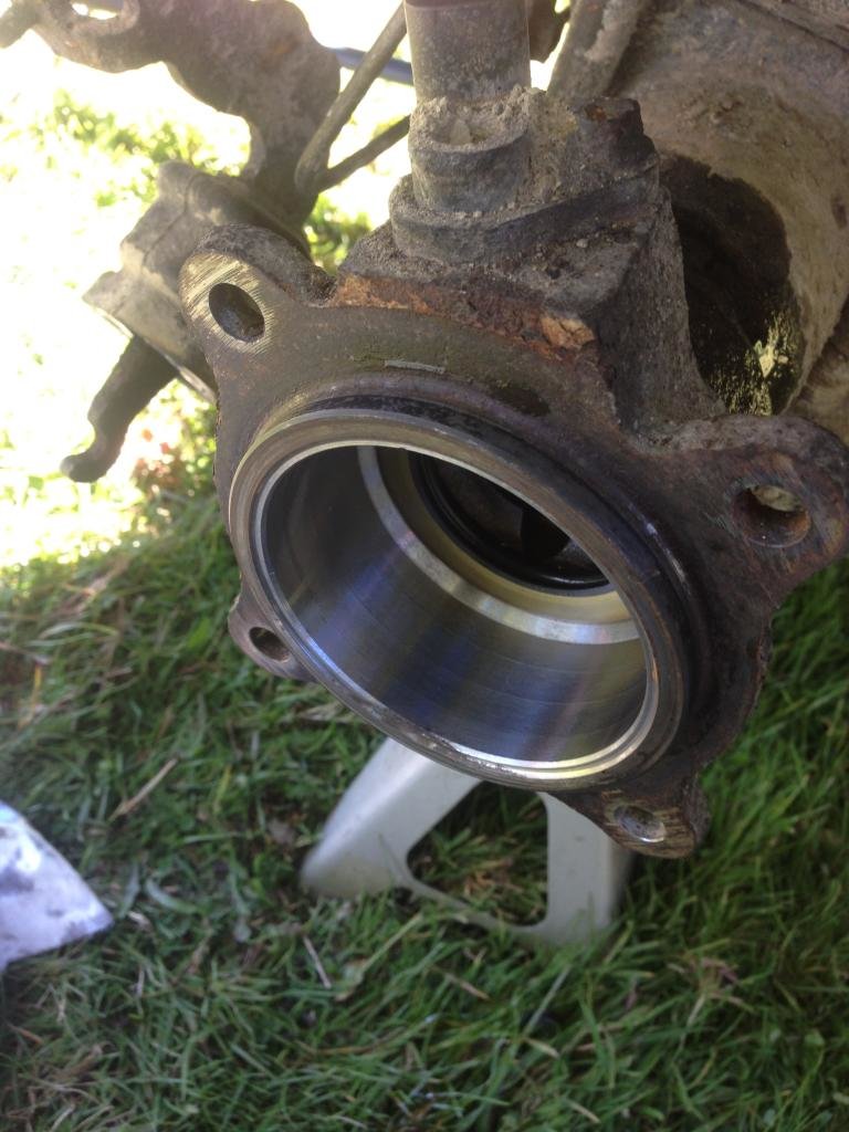

    Has anyone ever put rtv where the axle shaft bolts to the housing? Mine had that so idk if it's a bandaid or if it actually stops the fluid
  10. Sep 21, 2016 at 8:28 PM
    Squeaky Penguin
    Squeaky Penguin Nothing Ventured, Nothing Gained
    Apr 5, 2012
    #76340
    10,069
    Brett
    Steamboat Springs, Colorado
    '01 4WD, SR5, TRD & '13 TRDOR AC
    Lots of dust and custom dents, Check Build
    If oil has gotten to there your seal has already failed as oil has gone through it and the bearing.
  11. Sep 21, 2016 at 8:41 PM
    anthony250f
    Feb 18, 2012
    #73066
    16,772
    Anthony
    San Diego, CA
    I've never seen any there and didn't see any when I pulled the drum off... So I should be good to go?

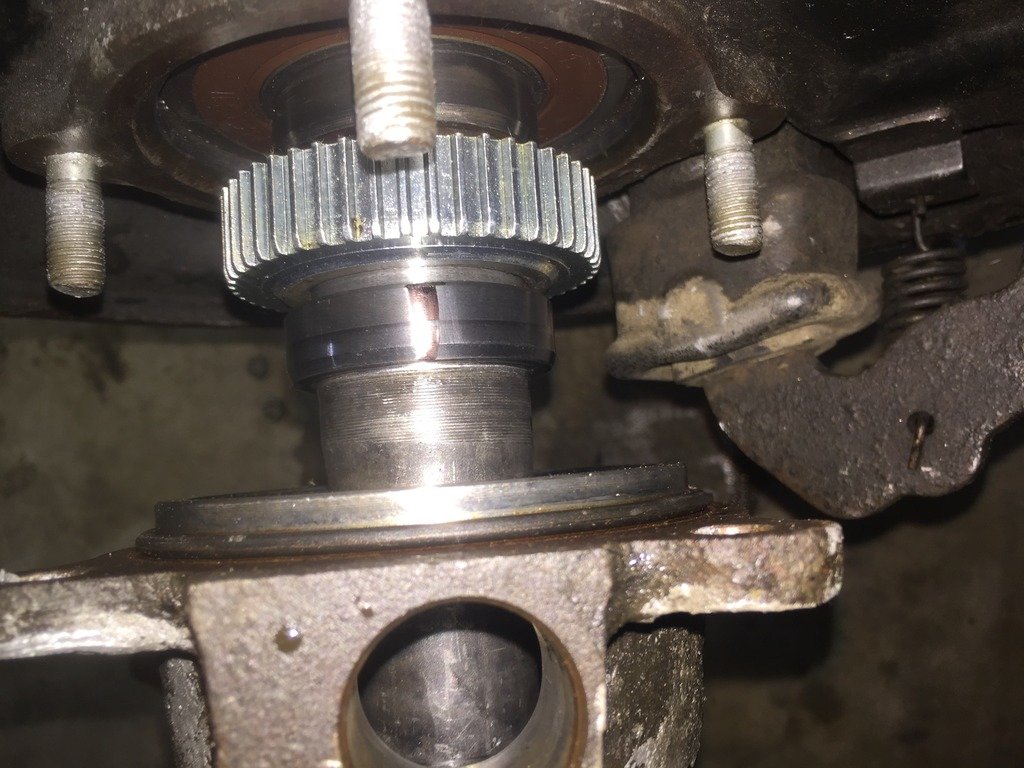

    I did because i didnt have an o ring big enough to replace them at the time.
    Edit:
    I assume your talking about here. As you can see mine was pretty crusty.

    No RTV needed because it is supposed to have this o-ring:
