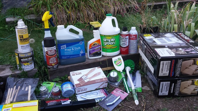

    Yesterday I purchased (or had delivered) these items.
    The most important item is that harbor freight 1.25" to 2" hitch adapter. My wife and I have a receiver hitch mounted bike rack. This is going to be installed on my wife's Subaru to eliminate her new excuse to barrow my truck.

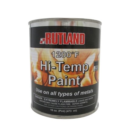

    In my shed i found this today
    I was wondering if it offers any protection to the muffler. It prevented rust on my indoor wood stove but that is indoors. The muffler is kinda rusty but not bad. might be oem. I wire brushed a small square of rust off the muffler and painted this on half of the little square as a poorly replicated experiment. Please speak up if high temp wood stove paint is commonly known to work or not work.

    Mine made it well over 250,000 miles and was still good when I replaced it. The stock one is pretty beefy. I don't think painting it will make much difference. Prolly won't hurt though.

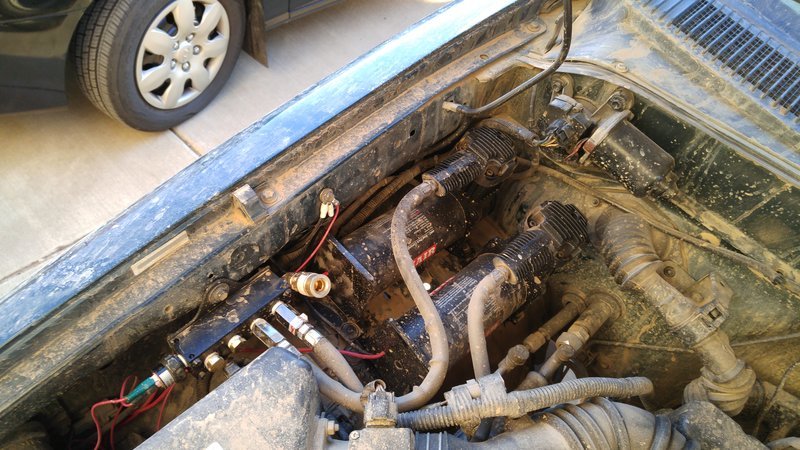

    Finished my OBA install the other day but never posted pics, so here it is. Two Viair 444C on a 6 port manifold with a 150 psi pressure switch that switches them back on at 120psi. Works well for filling tires thus far :)

    Hell yeah, that looks like great use of that dead space!

    Which model of Viair are those compressors?

    444C
