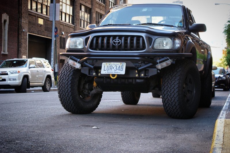

    put the plates on hold and took a little trip to NYC yesterday. And now Im sick today, so whenever I'm over this cough/cold thing Ill get those finished up...

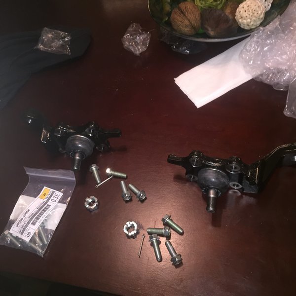

    Well I got my new lbj in and what do you know. They came with the bolts lol...now I have 8 extras. Also the 10933 is the same bolt they included so I would go with those.

    For sale?

    I'm gonna keep them. They are too cheap to sell. You can get them for 8$ shipped from camelback Toyota for all 8
