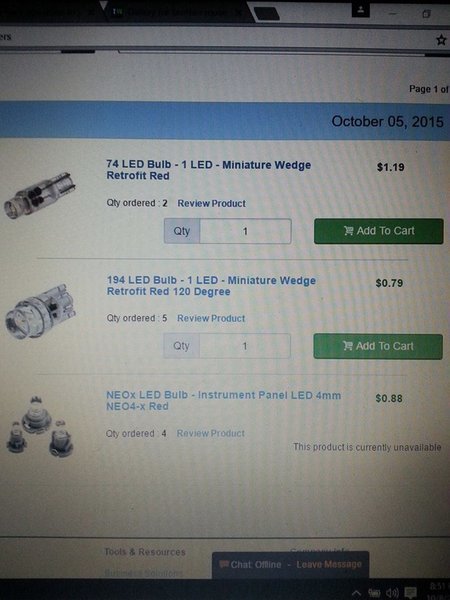

    Yup, as mentioned, its all pop out old, insert new, check to ensure they work before reassembly. also, these are the ones I ordered but I did one extra of each as to have a spare. Sorry for the crap cellphone shot of laptop screen, its the best I got.

    Those bulbs wont work very good in the dash. You want the 360 degree ones.

    got any pix of the 360 vs 120? ive been running them almost a year and have no complaints. not like i can see anything behind the face plate anyway
    edit: the place i got them from sell that bulb in 90 and 120 degree. i opted for the 120

    I don't. but they dont illumate as evenly or as bright and give more noticeable hotspots.

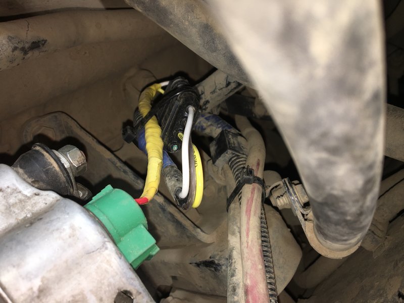

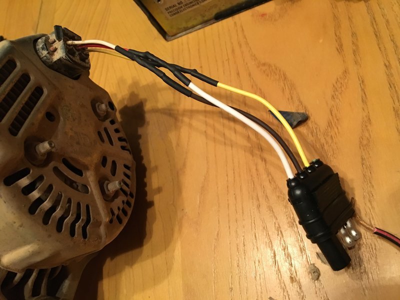

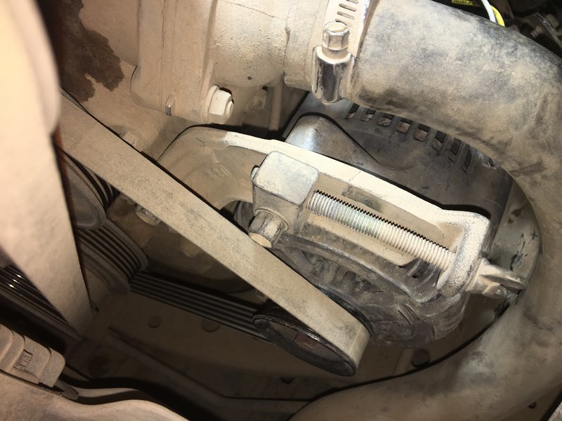

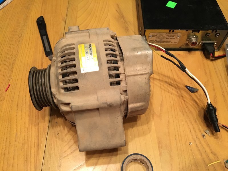

    Well, today I installed a new(used) alternator from a Jaguar XJ6, so instead of the tiny 60amp stock alt I now have a 120amp alt. This swap was appealing because the Jaguar alternator was also a Denso unit and was a direct fit physically (a bit bigger but still fits the hold downs correctly). I did like @Blackdawg and @Digiratus had suggested and made a conversion harness for it so I can keep my old one as an easy swap if this one were to fail on the trail. It is a super easy job to change out and now I can maintain 14.1-14.8V while my OBA compressors are on which is nice. Overall a very solid increase in power output for a total price of $60. Also shoutout to @Mikerocosms for trying this out so long ago.
    Here are some pics...
    Baby Stock Alt (with newly made conversion harness using trailer plug)

    Closeup of Just the Harness

    New/Used Jag Alt
    New Alt in Place

    Man, I would love to do this! Does it matter what year the alt comes out of? Also, can you give more info or point me to a build thread where that quick disconnect harness is explained, it looks simple but just want to be sure. How much did you pay for yours?
