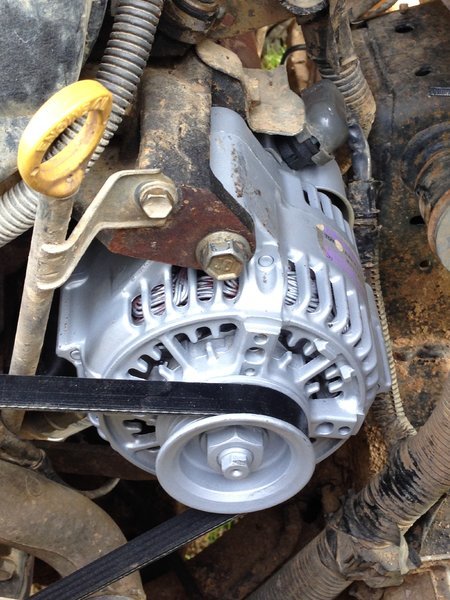

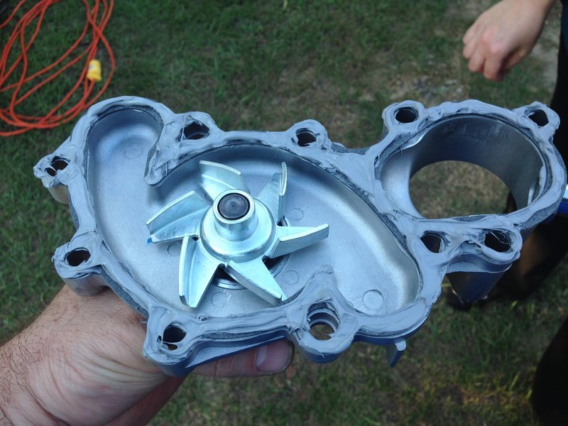

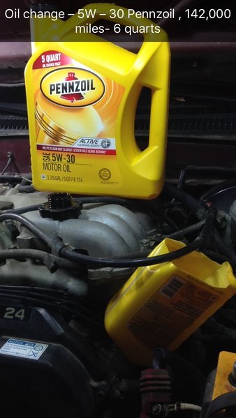

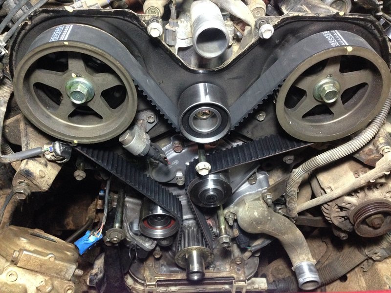

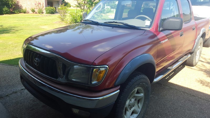

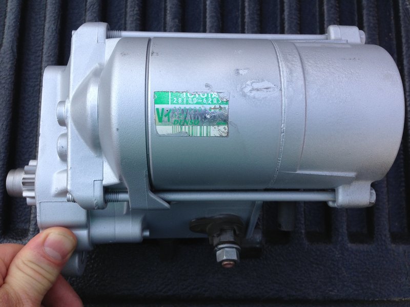

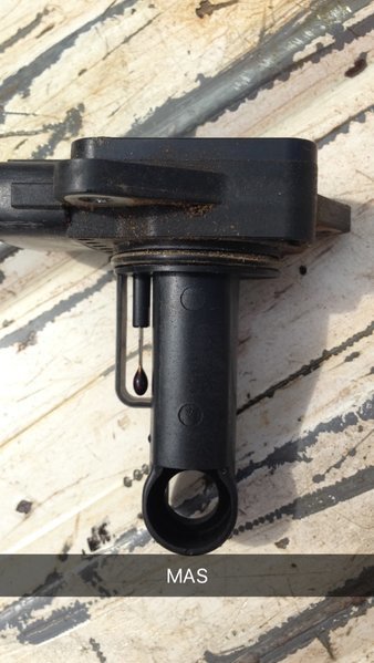

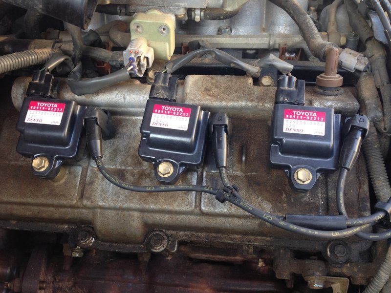

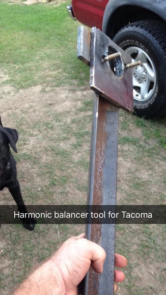

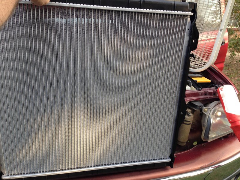

    We bought this truck in Sept '16 for my son to drive. 2002 Tacoma SR5, TRD, 4wd, v6, 142,000mi, it'd been sitting in a barn for 4 years+. We're updating several things- so far new water pump, crank shaft seal, timing belt, tensioner & pulley, belts- fan, a/c, pwr steering, alternator, rebuilt the starter & alternator, I broke the camshaft sensor- so a new one, 02 upstream sensor, cat converter, harmonic balancer, cleaned mass air flow & throttle body, 3 coil packs + wires + plugs, fan clutch, radiator + hoses + thermostat, added a Haynes trans cooler, repaired the clock, changed fluids & oils- tranny, engine, front & rear diffs, and transfer case, installed a magnaflo muffler + chrome tip, air filter, dielectric in most connector/connections. I'm taking it to the dealer for 3 recalls- inspection + ball joints + gas fill part, they've ordered the parts. Shop vac'd dirt dobbers, leaves, nest & so-on from the engine compartment.
    I'm planning to replace the wheel bearings- but so far this may take tools I don't have, I'd appreciate any advice on replacing front & rear bearings/seals and such. I'll work on the trucks exterior after I finish the mechanical parts. It has a dent in the- driver rear panel, tail gate, passenger rear door, paint is fading or clear coat looks like its peeling or something. This truck is running smooth, I can set a full cup of coffee on the engine and it barely vibrates.
    I'll post a few pictures. I have many more pics. I'm looking forward to taking my boys fishing & hunting in it.
    I need advice on the- bearings, flushing brakes & power steering, and where all the grease zerks/fittings are located.
    Thanks to all the how to post on TW...I couldn't have done this without your help.
    -Malcolm

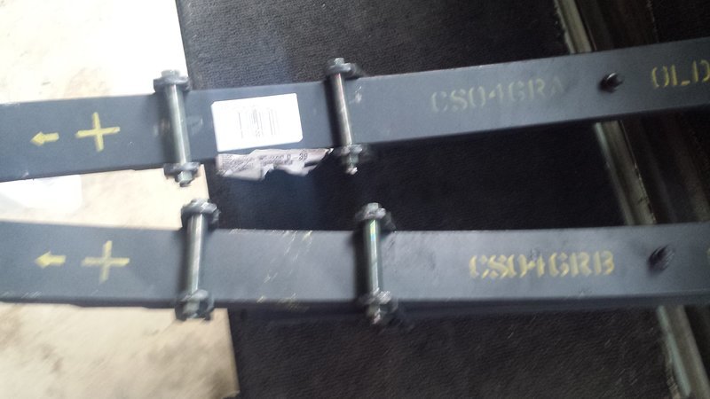

    when i put mine on i just set them next to each other to compare them. i took the one that had more arch and put it on the driver side. side by side youll see that one spring has much more arch than the other. like stated earlier this is to adress taco lean. more arch=driver side, the wimpier one=pass side.

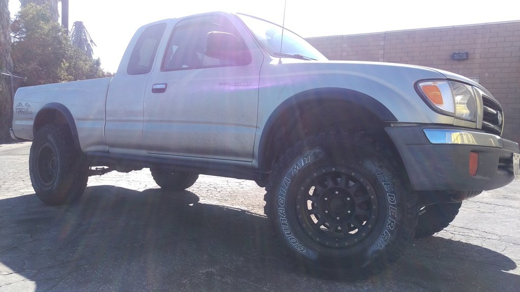

    so far they seem to be great, quieter than I expected for how aggressive they are. I am running 285/75/16

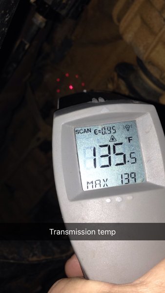

    I have the A340F (30-40LE) automatic tranny, it needs Type IV. There are several good brands out there. My front & rear diff oil was dark dark gray, most likely the original fluid. I put 75W90 in my diffs & transfer case. Everyone has their brand they grow to trust- Mobil 1(Auto zone), Red line (online), Lucas, Valvoline and such. The fill & drain on the rear diff & transfer case is 24mm (remove fill plug 1st). The front diff is Torx T55(cheap set at Auto zone), and isn't easy to fill- to make it easier and less waste use a pump style filler. They're cheap and it'll make it a lot cleaner (I lost 1/2 qt when filling the front, due to the tube popping off- soaked me good).
    When I'm using my trucks for hard farm work 8 hours/day I go old school and use 75W140, you'll need to be the judge of whether you need this heavy oil- hauling, towing, 100F+ heat and such. You get great gear protection, but MPG will drop a little. Always check your FSM or a trusted dealer for solid advise.

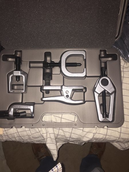

    Other than a press what's the best way to get the aftermarket UCA slug into the spindle?

    I used a press but they slid in with very little effort.
    You could try freezing the slug adapter and heating the spindle, and I bet they would tap in without much fuss with a deadblow.

    Yeah I know it's been a while :rofl:
    I was gonna freeze it for sure, won't have access to a torch but hoping freezing it and greasing the shit out of it and using one of the tools below or an Autozone tool would get the trick
    I plan on using this set or a tool from Autozone

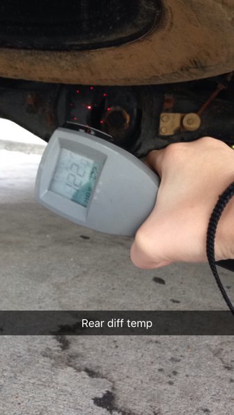

    Checked the temps this afternoon after a good trip. Rear diff: 122F, Front diff: 85F, Transmission: 135F, Transfer case: 122F
