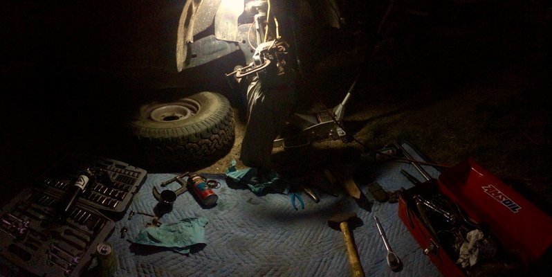

    Passenger side brake caliper seized up today... three of the four pistons wouldn't budge. Nothing like workin in the dark to get it done before work tomorrow! I work each piston back and forth, clean/spray lube/light duty grease..repeat until smooth, re install rubber dust shields, de-grease caliper/rotor. Good as new :thumbsup:

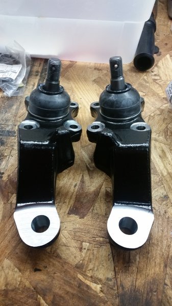

    New OEM LBJs for mine and my dads trucks. $200 piece of mind per truck, I guess.
    FYI the ones from Camelback Toyota DO come with new bolts. I have 16 extra OEM bolts, anybody need some?

    where'd ya get em? Im looking to do mine before winter too

    https://parts.camelbacktoyota.com/partlocator/index.cfm?siteid=214329

    I'll take a set of the OEM bolts.
