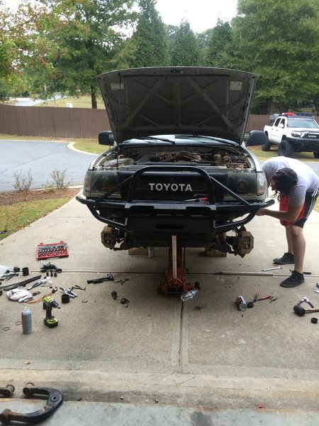

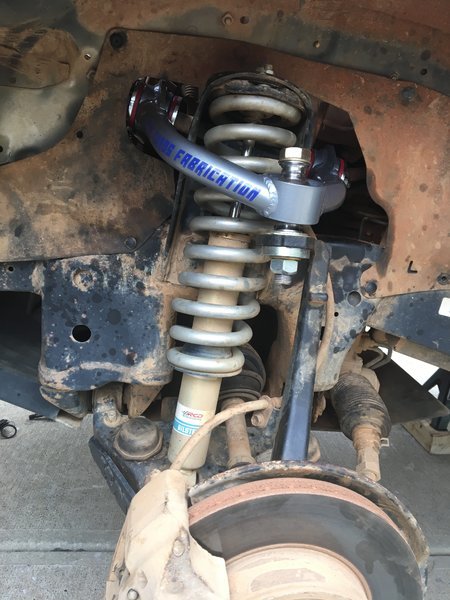

    to get the bolt out did you need to remove the airintake and/or battery or no?

    The long UCA bolt? I didn't have to remove anything to get it out.

    How did it go?
    Edit: I read it went surprisingly well. That's great. What tool(s) did you use to press the ball joint out?

    Nope only a wire loom and a relay on each side. Super easy
    I got in a GB a while back from Toytec
    It went extreme easy, literally throw them in the freezer and it'll help a ton! Used the tool you rent from Autozone (my buddy owned one) to press it in. It was super easy. I used this tool and swapped it on each side of the joint. It's a tie rod puller. It popped 2 UCAs, 2 LBJ, and 2 tie rods. Literally was clutch af to get it knocked out
