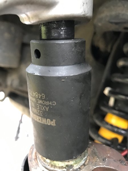

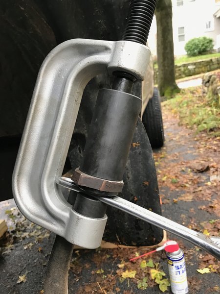

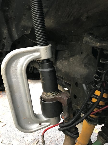

    95.5 OME
    Just finished up pressing in new UBJ for both sides. Trickiest part was pressing the ball joints in straight. Both sides began pressing in unevenly but pressed into place in the end. There was one tube in the ball joint press kit that had a taper on it, so I used that to straighten them out before switching to another tube for the final press, if that makes sense.
    These first two are of the UBJ coming out. I had to use an axle nut socket to fit because none of the ball joint tubes fit correctly. Too small or too big.
    Here it is going in. I used a wrench to spread out the pressure more evenly. Again they were a bit tricky to press straight.
