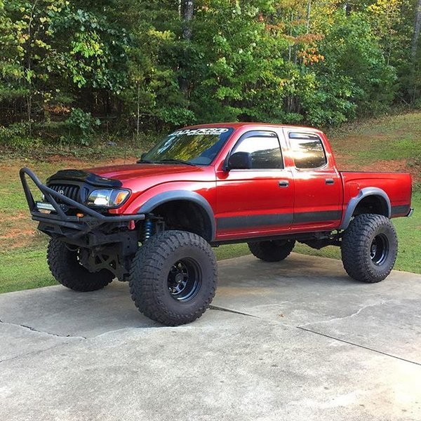

    Possible upgrade you could get for the future. See if you can buy a fabtech diff drop that comes from the 6" lift kit. Extended King shocks that provides 6" of lift in the front and new leaf pack in the back. Than say buy to that body lift :D here's a picture of one.
    Edit: I might not do this......... but it's just reference.

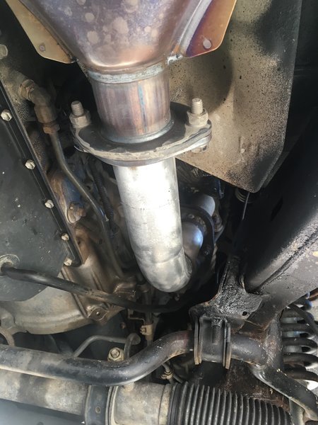

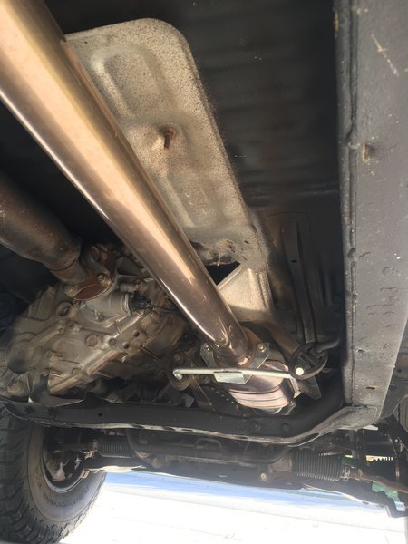

    Got around to replacing the original exhaust on my 1999 250,000 mile 1st gen...all of the O2 sensors and flange bolts on the cat were pretty much not workable with a tool so I ended up replacing the Y pipe to the tail pipe.... Went with a Bosal Y Pipe and Catalytic Converter, Denzo O2 Sensors and a Borla Catback Exhaust. I pretty much chopped the old system out with the sawzall, cut off wheel and recycled it (sorry no photos) the old muffler I'm suprised even passed emissions. Since I had it up there I also finally got some time to put in my Lowrange Rear axle breather mod, which I ended up stubbing out next to the gas cap.
    New Bosal Y Pipe and SS Hardwear.
    Bosal Catalytic Converter and new hanger and Intermediate Pipe.

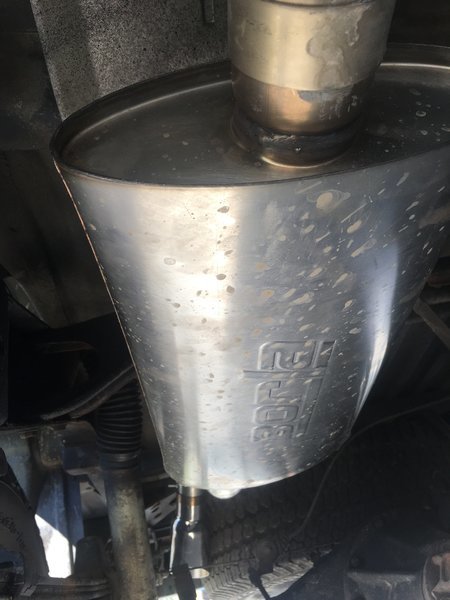

    Borla Touring Muffler (should have taken pics on the lift when it was all shinny and new).

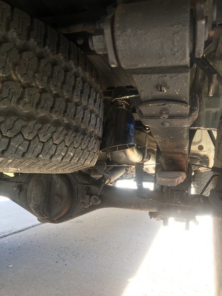

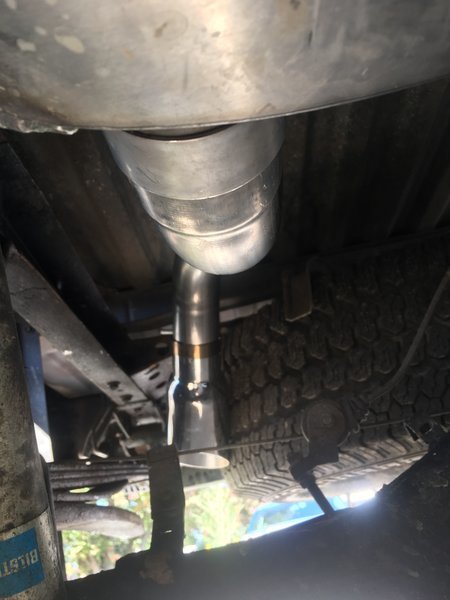

    Tail pipe to turn down behind axle...I tried the turn down right after the muffler and it was far too loud, couldn't hear my self think but it did sound great! (Yes) it touches the spare I need to get a bracket to pull it over a little bit more.
    Turndown just past the axle, with intercooler tip should be enough room to move it off the spare...(hoping to get a Relentless bumper with the tire holder mount for full size spare soon).

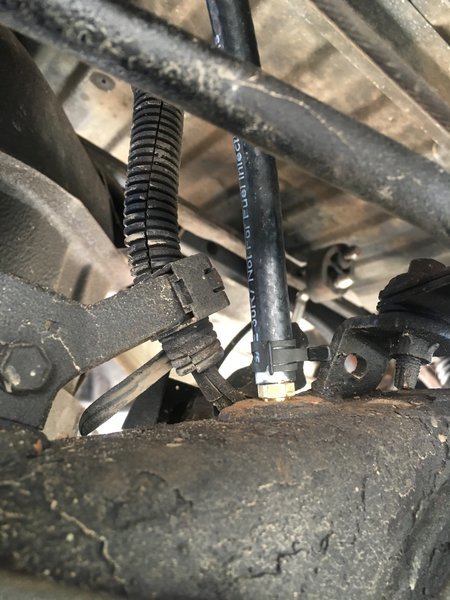

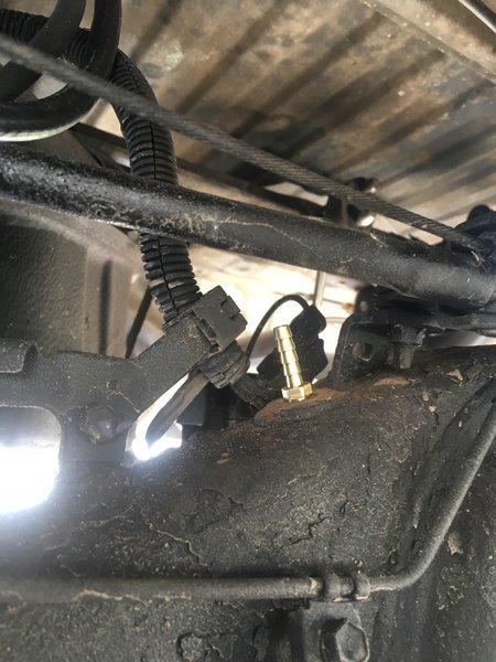

    New Barbed end for axle breather.
    New rubber hose ran to vent up and over the fuel tank and trough the frame.

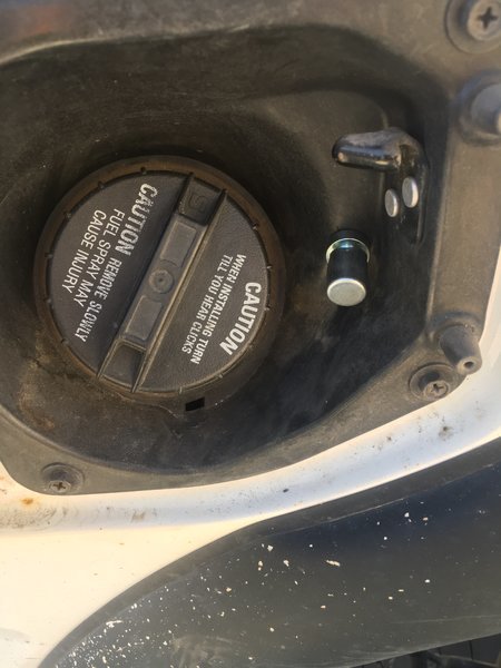

    Breather vent mounted in the fuel hatch (drilled a smaller hole and sandwiched the vent and hose to the plastic housing).

    So shiny! Nice work.
