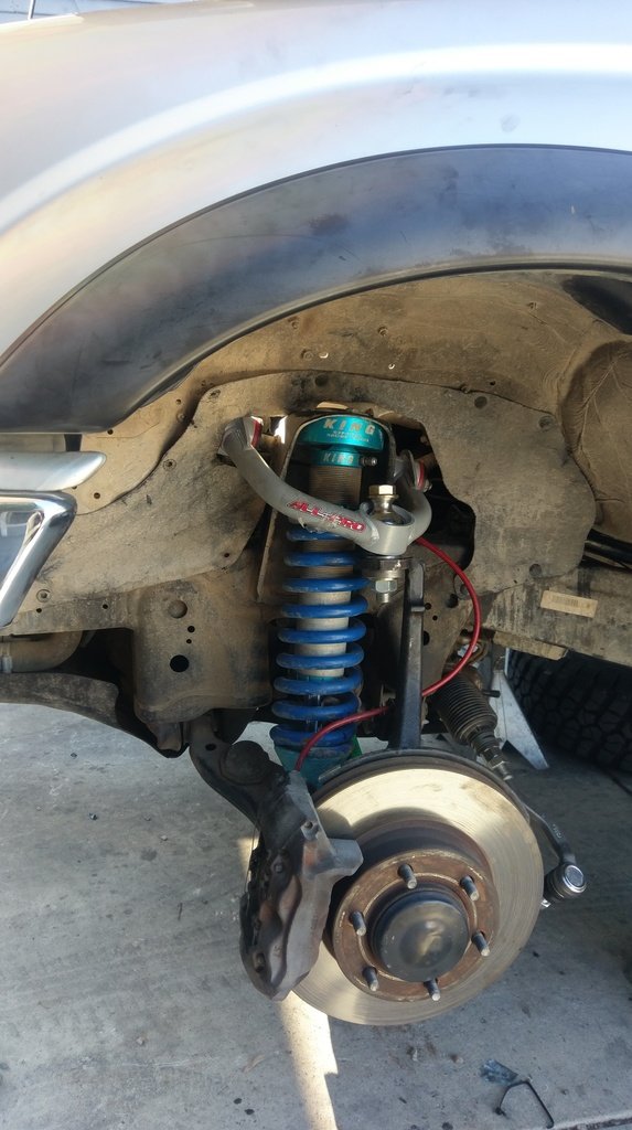

    Nice! How was pushing the slug into the spindle and getting the stock ball joint out?

    Surprisingly easy. The hardest part was separating the control a from the spindle, nothing worked....we had to cut the bolt off in order to separate them. Luckily I wasn't resting the stock arms, otherwise I don't know what we would've done. I mean we tried everything to separate them too.....they were seized on tight. But it's done, now to the alignment shop this afternoon.

    Nice! Interested to see the numbers you get. Maybe my difficulties getting the slug in were a one off case haha

    I'll let you know for sure gotta wait until 3pm. I froze the slugs before pressing them in and used the press kit that I rented at O'Reillys.
