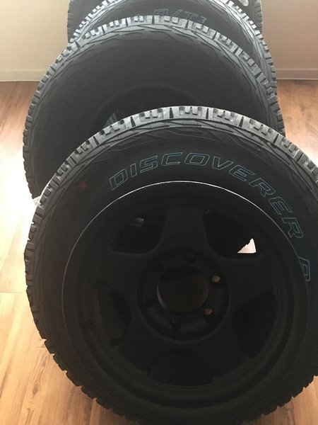

    1999 3.4L V6 Tacoma, 4x4, TRD Supercharger
    New rubber + New kicks!
    Sadly, won't have them installed till Friday :annoyed:
