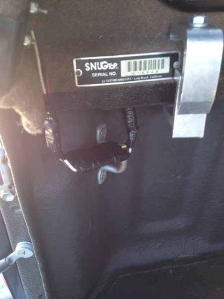

    Hey weird question guys... I am going to buy a cheapo canopy and I'm wondering which clamps work for our bed rails. They curve over a lot and I'm not sure which clamps will have the clearance.

    These are what I Use, Wyoming Wind approved.
    http://www.ebay.com/bhp/canopy-clamps

    If you have a shell dealer anywhere near you check there. I was going to order from eBay, but bought them at a leer dealer for $7 each instead.
